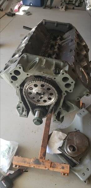

I used the exact heads, 440 Source Stealth heads. Externally left them alone, but did send them to MM for them to replicate the same CNC on them. Block was line honed, bored .030 and rotating assy was checked and assembled by my machine shop in Vegas, "Insane Power".

I used the exact heads, 440 Source Stealth heads. Externally left them alone, but did send them to MM for them to replicate the same CNC on them. Block was line honed, bored .030 and rotating assy was checked and assembled by my machine shop in Vegas, "Insane Power". View attachment 1129597View attachment 1129598
Interested in this build, is there a thread on it? What about the serpentine set up?

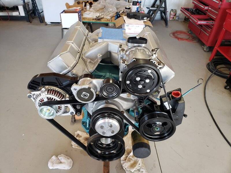

No, I did not do a writeup on the build. I just copied the build I referenced but went 496" instead
. Pretty straight forward. As for the serpentine setup, it is a Superior Design Concepts. Issue after doing is fan/shroud fitment.
