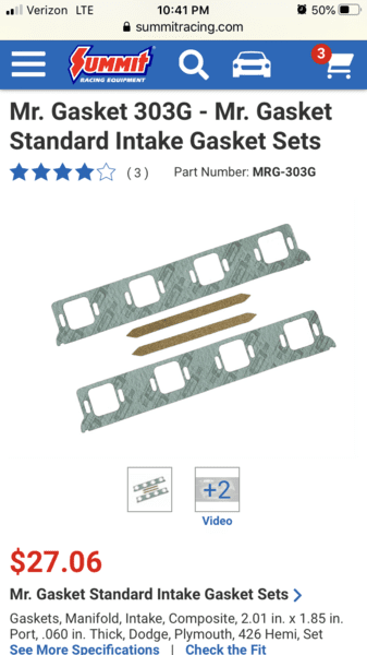

yep the thin one that superformance has I will get a thicker one to try next go around. I even thought about O rings in the intake but I hear that’s pretty pricey.How thick are your intake gaskets? If .031 a little on the thin side. If you need 1/16" or .060" gaskets got some. Thin gasket won't compress that much to seal the bottom edge.
Intakes on Hemi's are well known for sucking oil past the gaskets.... The bolts are to small & the surface area is to great.....
buy this & use it..
https://www.amazon.com/Three-Bond-1...ocphy=9028308&hvtargid=pla-442183411101&psc=1

Think mating would have be close to perfect for o-rings.yep the thin one that superformance has I will get a thicker one to try next go around. I even thought about O rings in the intake but I hear that’s pretty pricey.
