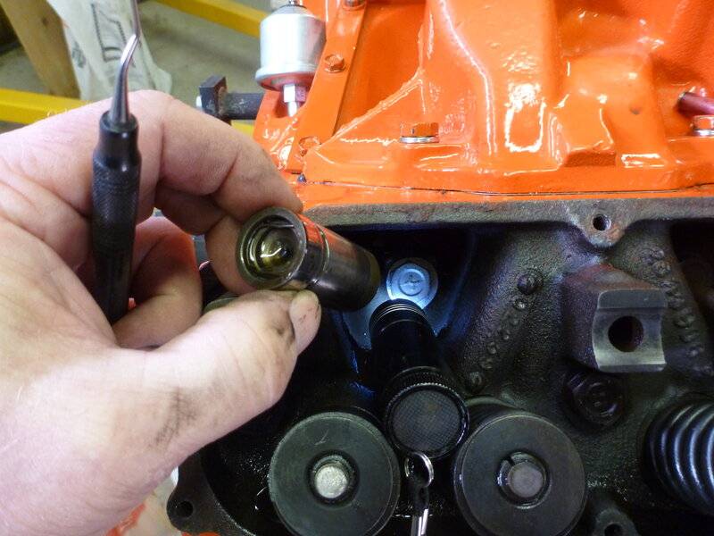

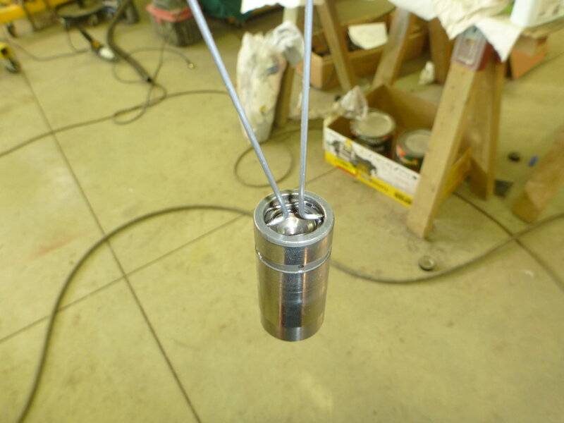

Unless Stealth heads are drastically different in shape than stock, no need to pull anything but rocker covers and rocker shaft assemblies. to get lifters out. That said a "rattle" doesn't sound like a lifter...
Something in your exhaust system?
if temperature related, maybe the lifters have to pump up every time. My 440 did that until I switched to Rotella diesel 15-40 with zinc additive. now -10 below and it starts and idles like it was never shut off.
View attachment 1078907 View attachment 1078908
Just an fyi...Stealths (and most all aftermarket aluminum heads) have small holes for the pushrods instead of the one big opening like factory heads have....gotta pull the intake/valley pan.
