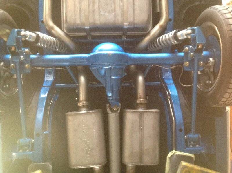

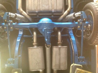

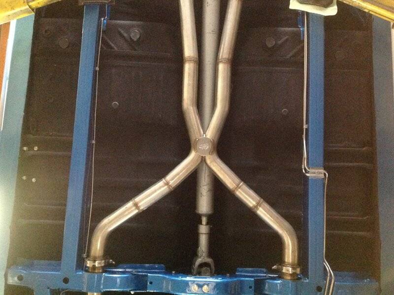

I have a 5.7 in my 70 GTX. I talked to the lead engineer at TTI and he said he could NOT get a set of headers to work because the bends were too tight to get around the starter!. I went with the stock manifolds into this... 2 3/4 "pipes into Dynomax VT mufflers. I have since added cutouts as well. Sounds great and performs outstanding. I don't think the return on any HP would be worth the hassle.

Oh ****, that right! B bodies can use the factory exhaust manifolds, A bodies are where the fun starts. Thanks Darius!!!
