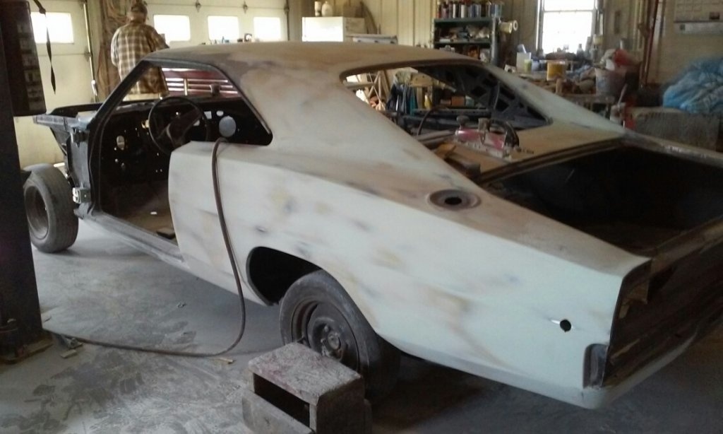

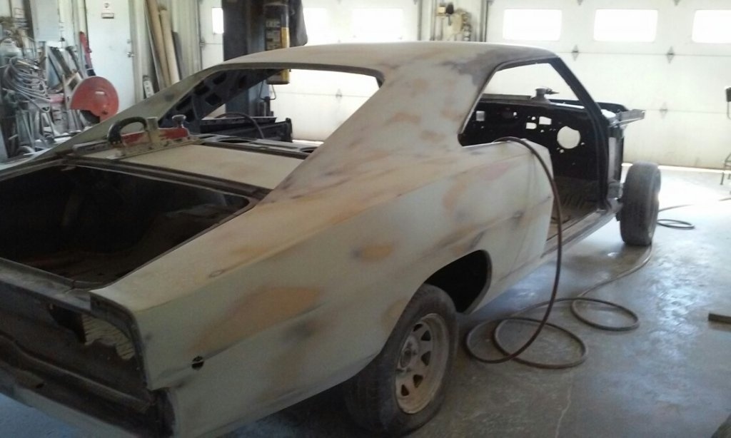

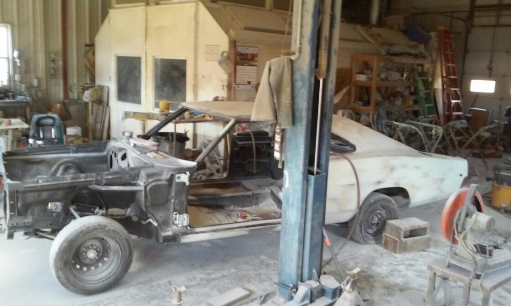

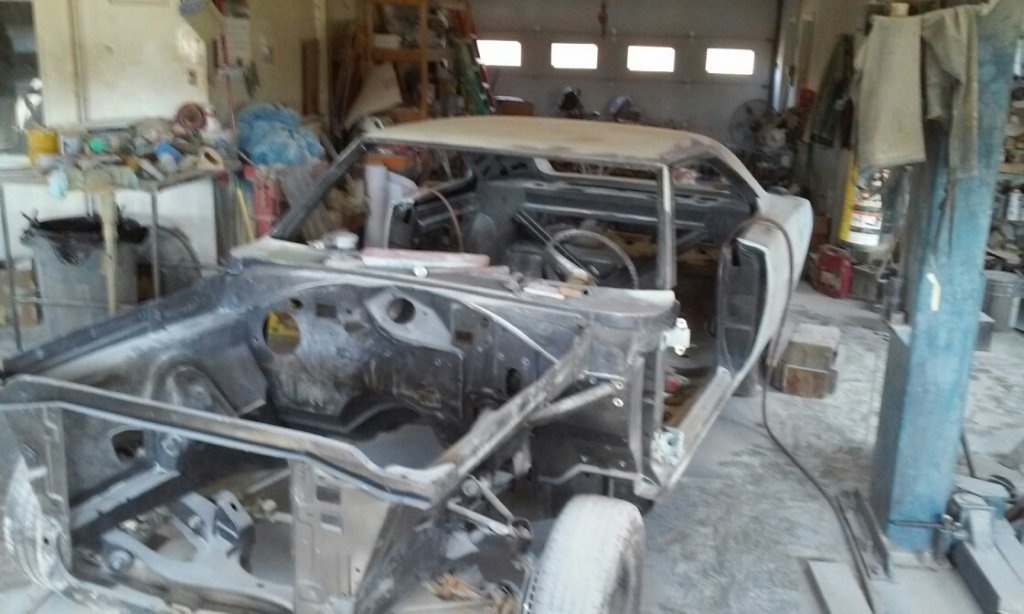

Got some pics today. I meant to get some of inside the roof, but forgot. He had trouble get the roof smooth so he used a trick he had of welding a few 1/8" x 1" metal straps/braces front to back in between the 3 main roof frame rails. I thought it looked pretty cool, kinda nascar-ish and adds a little more safety, sorta.

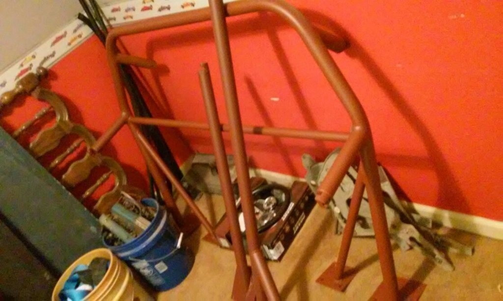

I primed the rollbar and have decided rather than weld a tab and bolt the shoulder harness I'll use/buy the wrap around connection type. My seats have holes for the shoulder belts to go thru so that will keep them centered. Still undecided about the color for final paint on the roll bar. I'm thinking I may go with a hammered red. Lowes has a it in spray cans for $6. And black for bar pads color. I expect some dislike to a red roll bar but one good thing is I think it may make possible cracks more visible than black, not that I'm expecting any cracks but I'll be looking the car over after getting it running I'm sure.

So what do you think about my red hammered roll bar idea? I think I mentioned a while back how I'm planning on black paint job for the car with a red tail-stripe, and a few other red items, such as carpet, harness belts, and maybe headliner. Everything else on the interior will be black, with a few shiny aluminum panels to cover the deleted backseat. May invest in a cheap bead roller.
To me it sounds like a good idea. I think that it will look good with your paint scheme. I like the sound of a little red accent to pull it all together.
I think with a red interior it would look good.
A good way to check for cracks is to install a schrader valve somewhere on the roll bar. If the piping is airtight and holds pressure, you have no cracks. If a crack does show up, you'll hear it. It helps to plan for this at the outset so you can make sure all the piping is connected in a way that it will be pressurized all over from a single source.
