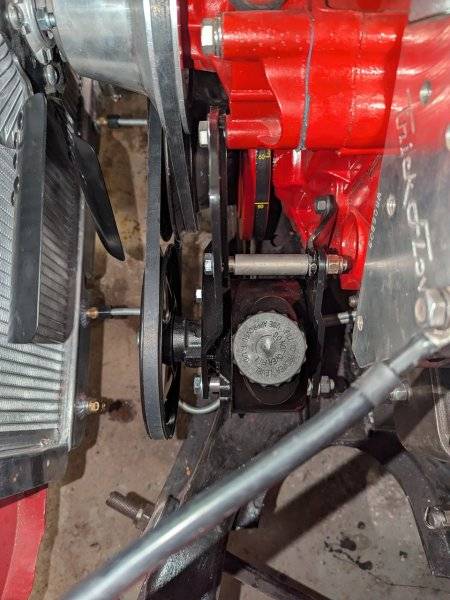

Ok.... power steering is on other than the lines... done for tonight though. Belt alignment isn't as good as i would like.. modified it a bit but not enough.. will just pray it doesn't throw belts.. if it does i'll fix it..
This is the bergman kit btw......
Just posting a couple of better pics in case anyone does this kit and needs to figure out the spacers (have to space the pump back off the bracket) Also cut the welded on nut off the lowest bracket that goes to the 2 timing cover bolts so the bracket will go over the back of it..
Where did you buy the Bergman kit? I saw 440 source sells brackets also.
I bought it straight from Bergman.. talked to him on the phone beforehand.. really nice guy. The kit literally has every thing you need other than directions :) not that it's hard.. just didn't know bout the spacers and **** is all. I need to make the belt alignment a little better than put the hoses on still. It got ball freezing cold out and i am in hibernation mode for now.

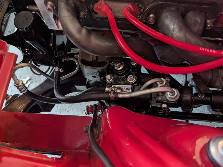

Soo.. had one day of nice weather (60 in late december... wtf... ) wouldn't mind all winter being like this though... finished up the power steering and went for a quick test drive.. Steering works good, no leaks and is actually a bit lighter than i expected, it feels like my 66 new yorker did. Although the car does wallow around like a fat pig on ice.. but that's ok, i take corners slow :) Brakes are much better with the new MC, still not amazing but the pads only have like 10 miles on them, i'm told they will get better when they break in. Also need to get them bled but had plenty of pedal.
Posted this pic on imgur and ate **** for normal hose clamps... didn't know what other ones to get.. Oetiker clamps look like a pain in the ***. Oh.. almost might get a power steering cooler though. that pump gets really hot and most of my time is over 2800rpm.
