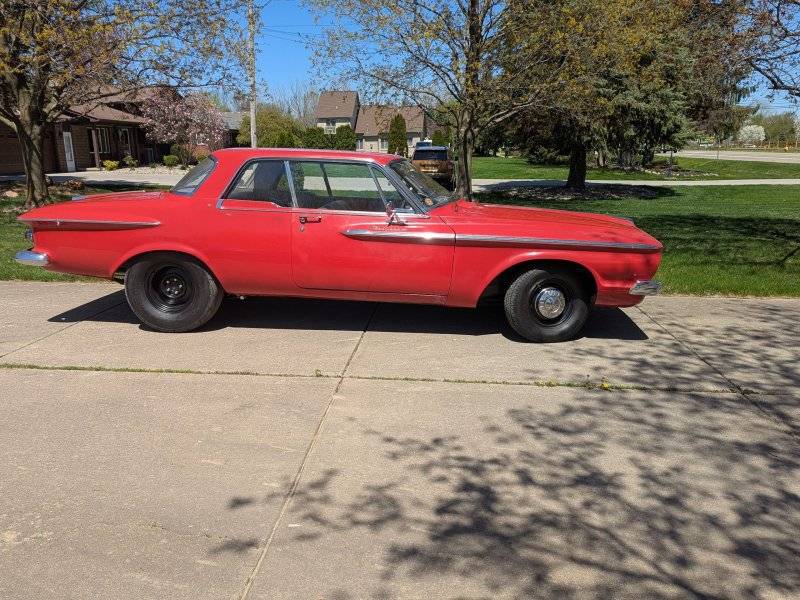

62 Belvedere 318 poly granny cruiser (one day i hope)

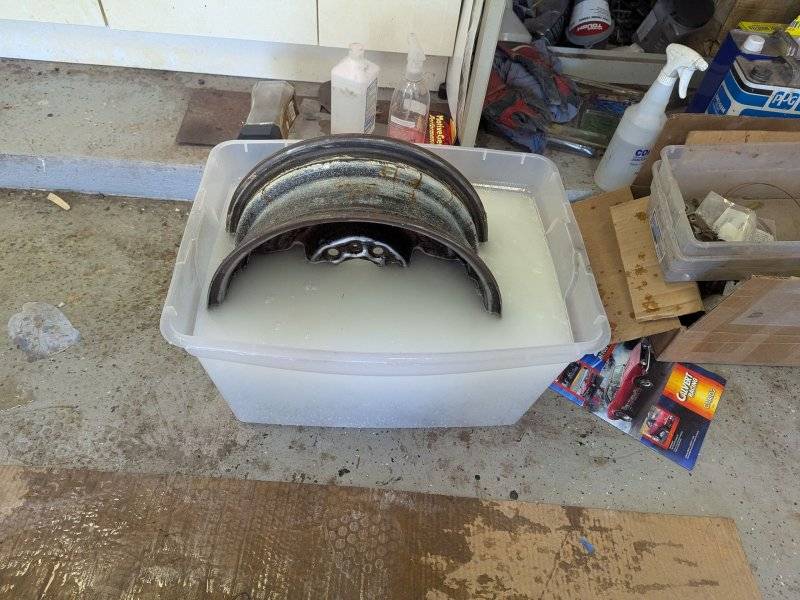

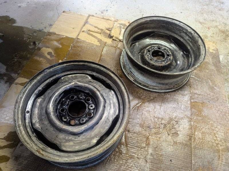

Also mixed up a big batch of evaporust and have my rims soaking...\

Haven't gotten much done.. finally had someone help me bleed brakes today... still a bit spongy, not sure why.. will figure it out... pulled the rims out of the tub.. pretty happy with how they came out...

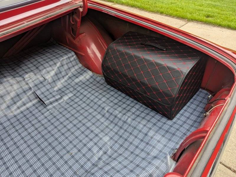

BTW... setup my trunk toolbox yesterday... someone on the forum told me bout these years ago, glad i ordered one..

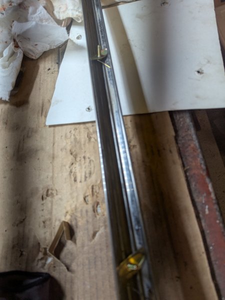

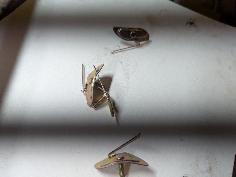

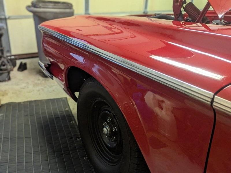

In another thread i was talking to someone bout trying to find these odd trim clips the '62 uses for the fender spear.. couldn't find any so i ordered some of these and used them...
(sorry bout the pics.. over heads were messing with my camera
First i bent them like this as the trim sits over a bulge in the fender so they can't be flush
Used 5 of them and the original spring clip for the back one you can't get to...
Held on nice and tight... trim is bout 1/8" higher than the door trim but my fenders are messed up (arizona fenders and expensive and they got something stacked on top of them in shipping and bent them bad... i did what i could...)
So the trim doesn't line up.. but nothing on my car lines up.. it really needs a new owner that can fix stuff properly :)
