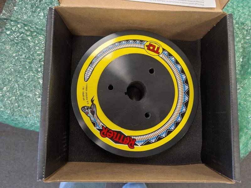

hate dealing with people... Been trying to find a TCI rattler forever... finally found a new one on ebay from a company not a person... i asked them to verify the proper one was in the box since people had complained of getting a chevy one in a mopar box.... ohh yeah.. double checked, it's mopar... thing shows up and it's a small block chevy one.. unreal. soo.. will probably put my stock one back on, could have had my car back together a week ago. My stock one looks ok. but the rubber is 40 years old... rather replace it. Didn't want fluid or consumables..

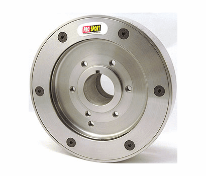

And the prorace looks like the summit/trick flow.. like exactly the same
Summit shows several. I have used the Professional Products balancer on two of my big blocks, and they have been great.
