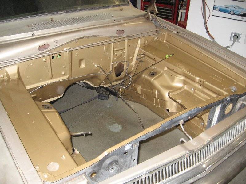

When the bay gets filled and all the pieces are back in, many issues will not be seen. Of course you'll know they are there. Its bound to be better than oe anyway.
me knowing is the issue :) i will clean it up a bit and it will be fine. it's so much nicer than the rest of the car it will be odd when i open the hood :)

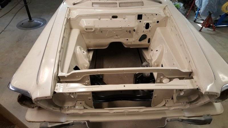

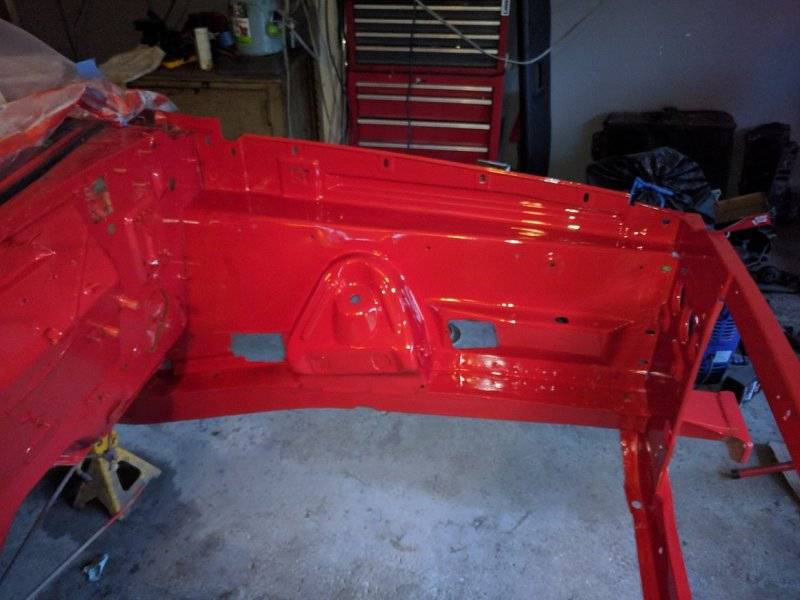

The first area I'll be retraining in is the engine bay, underside of the hood, door jambs and back sides of the doors. First go around will be with primers. Hopefully when its color/clear time, I'll be less likely to hang curtains.

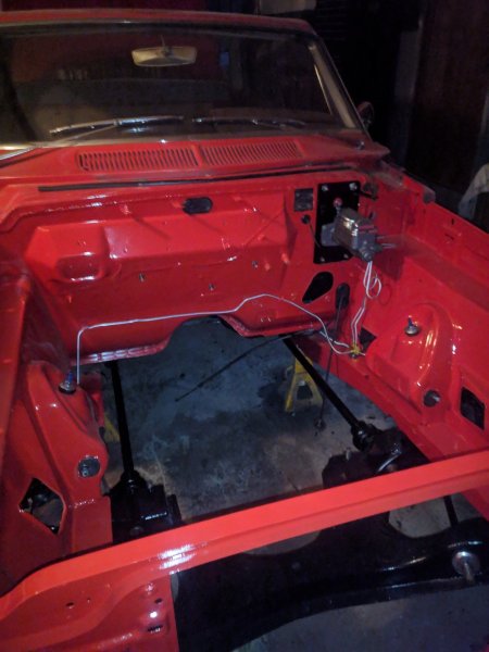

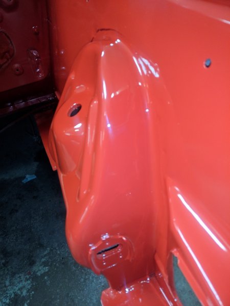

I got lucky and only ran one spot which was the back side of a shock tower where the cam bolt goes... just too tight of a spot to get the gun into so i hosed it :( other than that i'm ok with it... learned a few lessons

Been there, done that. Lots of work prepping the engine bay but the end result is worth it. Wait till the power-plant is back in.

Your end result is much better than mine :) came home with fresh eyes and really not happy.. prolly another 20 hours to fix the paint.. but will get there :)

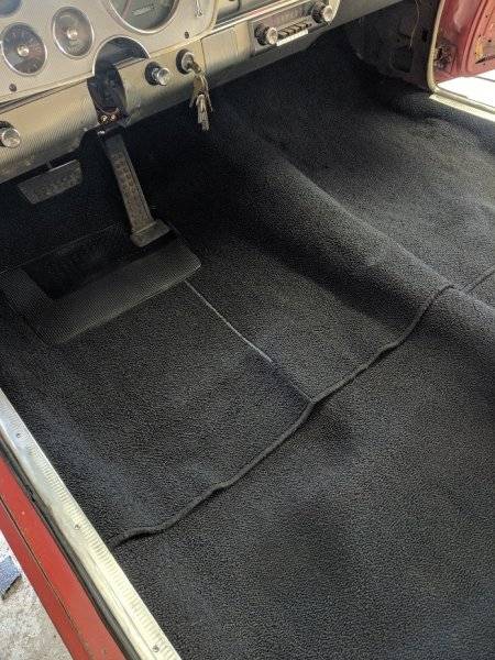

K.. wanted to get carpet in today and start getting my interior together (bitch doing my seats is ******* me, i literally don't have seats now and you can't buy them for a 62.. kinda fucked)
Soo.. i get the carpet in and drill the hole for the gas pedal.. it pulled a thread and fucked the carpet.. i'm soo bummed. No matter what i do i will **** it up every time.
Gotta love it when an inanimate object gets the better of you. Zen, have a beer, Zen and get back at it.

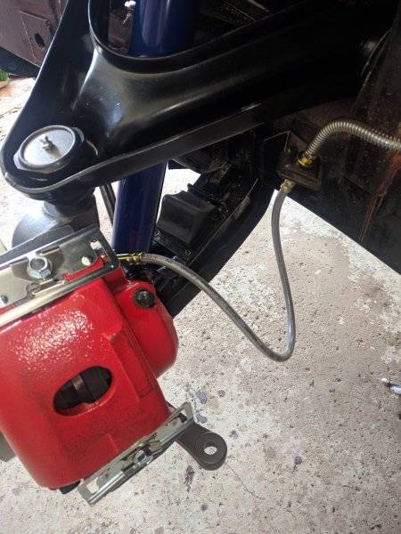

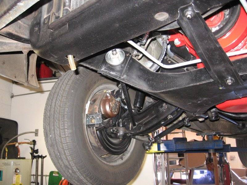

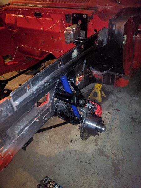

A little more done... brakes are complete other than fluid/bleeding.. (the TOO long flex lines are bugging me too much).. And suspension in, i don't think i will do the center link til the motor/headers are in, save myself that battle..

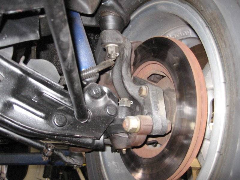

You may want to try looping your brake hose to the front and around the shock.
It travels with the control arms movement so no chaffing,or binding on turns.
Just a thought.
Just a thought.
Hadn't thought of that... will take a look when i get home.. Piratejacks will refund the lines if i want but they don't have any shorter ones, 18" for a 8" gap seems a bit much :) DrDiffs are 15".. don't wanna spend $75 to lose 3"
Another thought is swapping the calipers and hanging them from the front like A body cars.
They use the longer brake hoses.
yeah.. i thought of doing that, just don't wanna take it all back apart... cause A: I'm lazy... and B: it would take a whole hour :) I still might do that though
