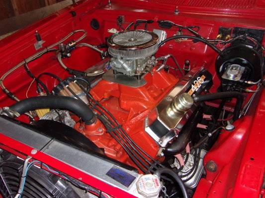

The one Im using is a B Cool as well. Quite a bit wider and mounts on the frame rails w/pins.
Also dual fans. Its a cross flow w/4 rows of tubes. Sorry no pic of the combo.

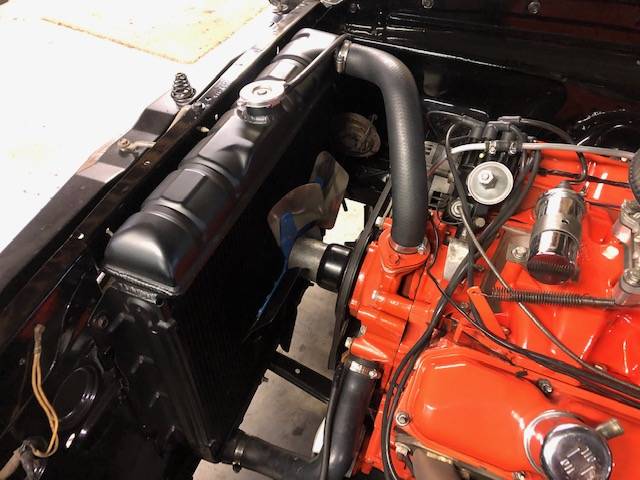

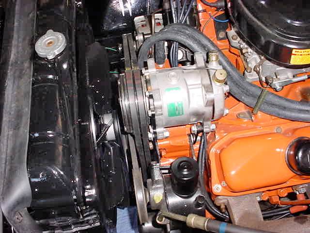

I don't have any measurements but I can get them later today. I thought these pics may give you an idea of how much room you have. I have an Afco rad I bought from Mancini and I use a back-up pusher electric fan that's on a toggle switch so I can turn it on if I am stuck in traffic. I will try to get in the garage and get measurements today. Ron

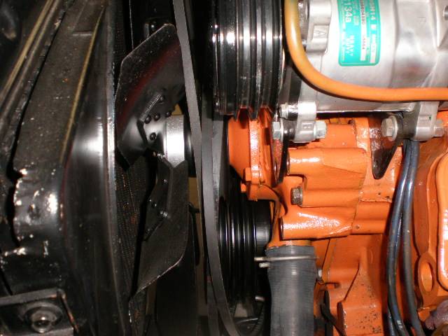

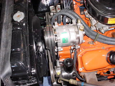

22" O.E.M. with 4 core with factory shroud,all I had to do was decrease the fan spacer length by 1/2"
