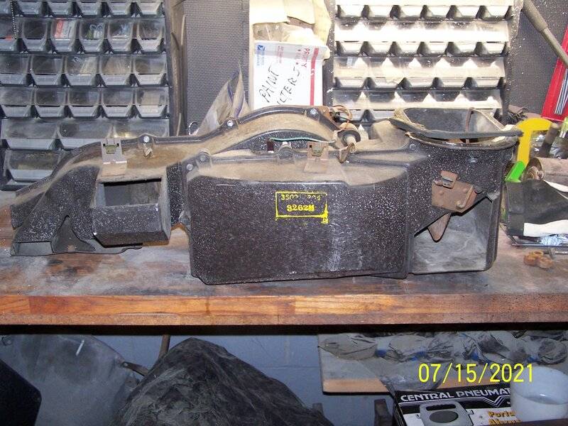

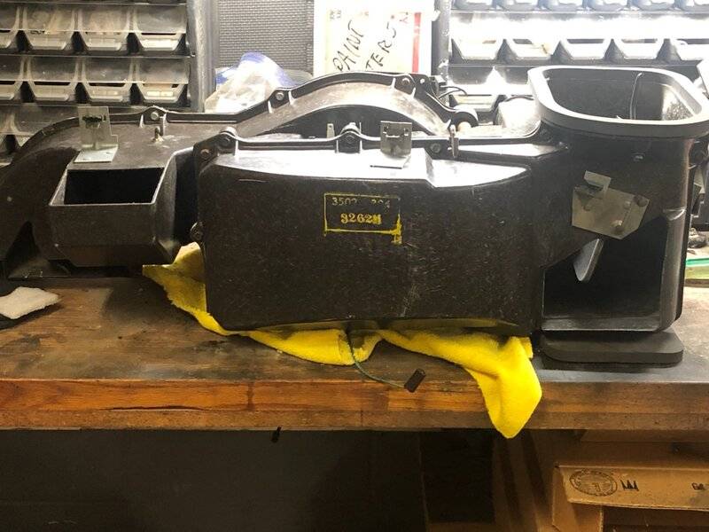

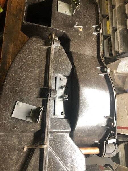

Lots of little things that would not warrant a picture but were needed for the engine to go in. Decided to rebuild the air box now before it got damaged sitting around the garage any longer. New heater core, gaskets, foam, etc .

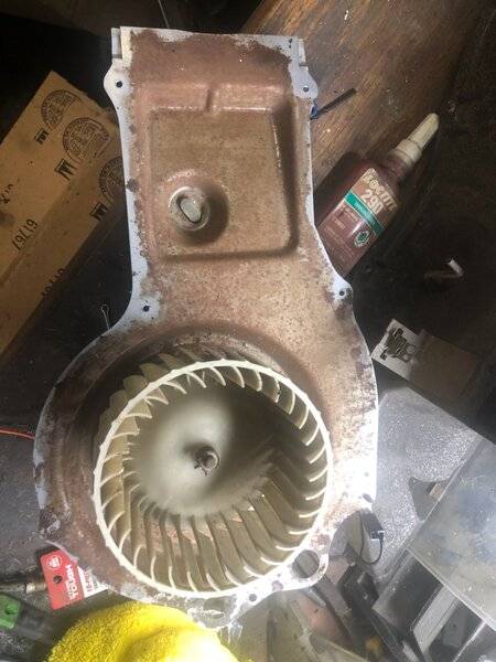

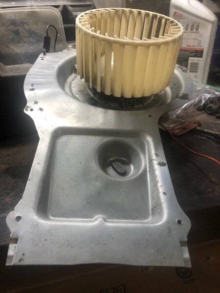

BEFORE:
AFTER
BEFORE
AFTER
Did you get a seal and rebuild kit for the box? How did you clean up the blower motor frame?
Yup, purchased a seal kit from DMT :
Mopar B Body 71-74 NON AC Heater Box Rebuild Restoration Seal Gasket Kit
As for cleaning the rusted metal, I use this:
It is pretty strong stuff and will take the rust off in 30 seconds or less. I just brush it on straight and work it around a little with a small brush. While wearing gloves, wipe up the excess and apply a second treatment. This is usually enough to get it clean. I then use vinegar as a 1st rinse (to dilute the acid). Then I use a 2nd rinse of baking soda and water to neutralize the acid. Then a 3rd rinse of the same. Followed by a 4th rinse of straight up water. Wipe up the excess water and heat gun the metal dry so it wont flash rust. Once dry and cool I spray with a clear coat.
Just be careful. I work with HCL at my day job so I know it's hazards very well. Gloves, long sleeves and pants, googles, a good cartridge respirator, and an outdoor space are pretty much required since the stuff is really bad for skin and lungs. Disposal is a little tricky too, as it takes a lot of bicarb to neutralize.
If you are not a fan of the acid treatment (as it is a little hard on the metal) you could also use Evapo-Rust (my second favorite rust remover). Much easier to work with and pretty non-toxic. It is slower but it does work very well.

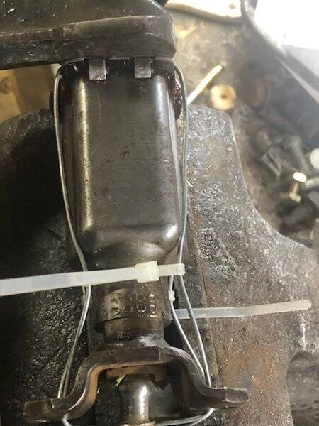

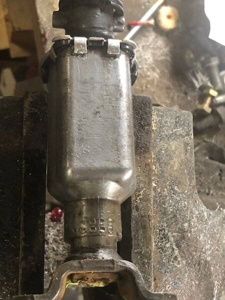

A few more little pieces before the engine goes back in, like the steering coupling seal and cover. What a PITA to do.
And then the $%^&*#$%^& dowel pin to hold it all together. Don't drop it on the floor or you will end up making a new one)

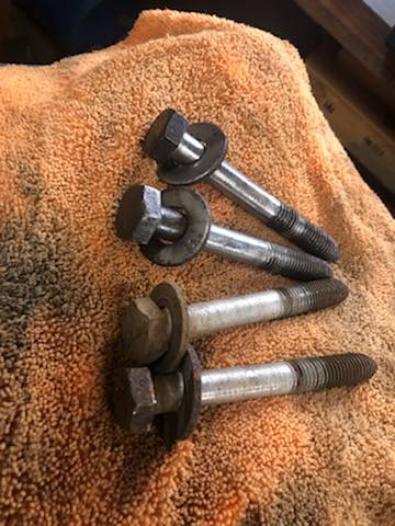

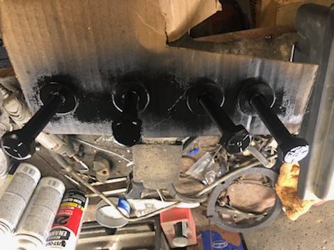

Cleaning up the K-frame bolts

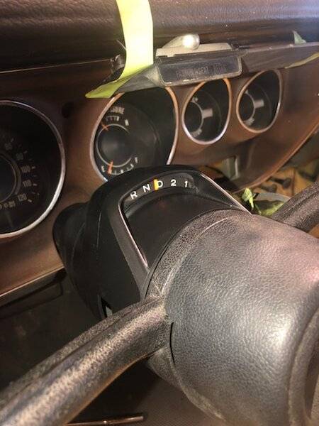

Column cleaned up and painted

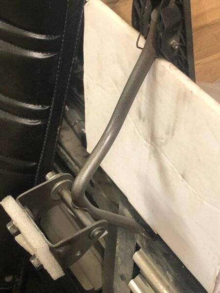

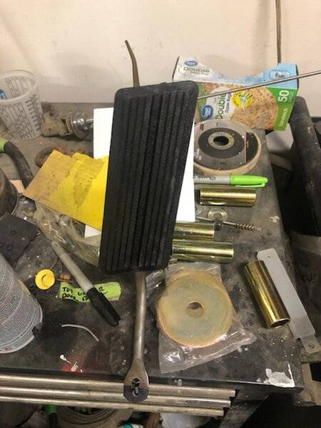

And the gas pedal

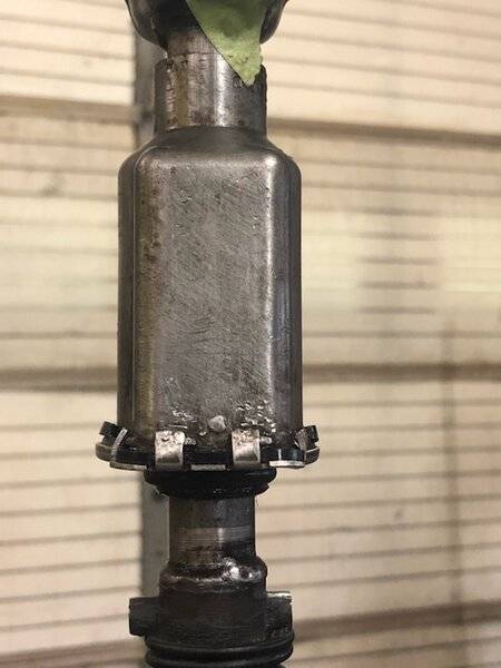

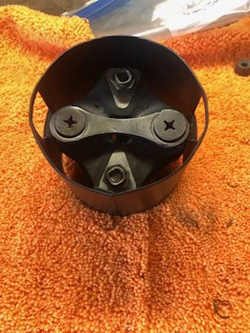

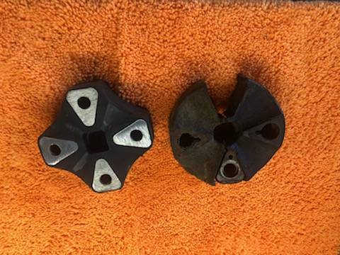

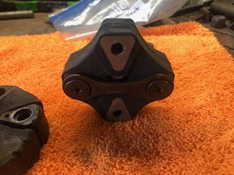

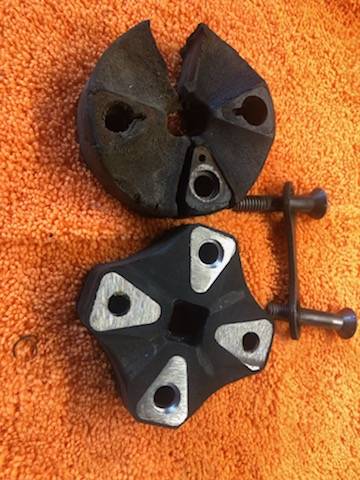

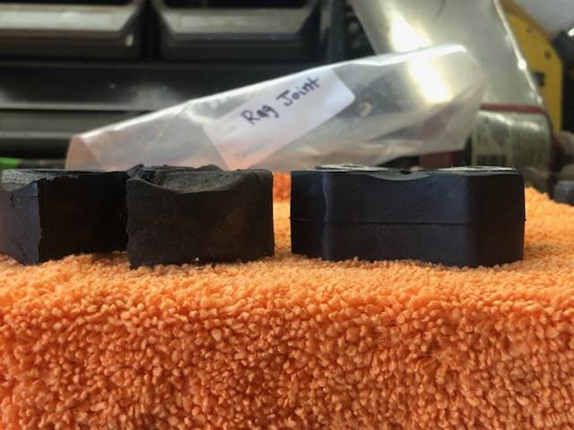

I was looking for a replacement steering coupler "rag joint" for this car but did not want to pay the crazy money an original one cost. Did some looking and found that a 87-91 Land Rover uses a steering coupler that is pretty much the same, but only costs around $25. So I figured I would try one out. The holes line up exactly and the size fits the guard.
I have very little room on my particular column so I had to grind about 3/16" off the piece and counter sink the holes for the tapered screw to fit just perfect
Here it is after I gave it a little hair cut
Side by side
Countersink the holes a little
Straps/bolts fit perfectly
And everything fits

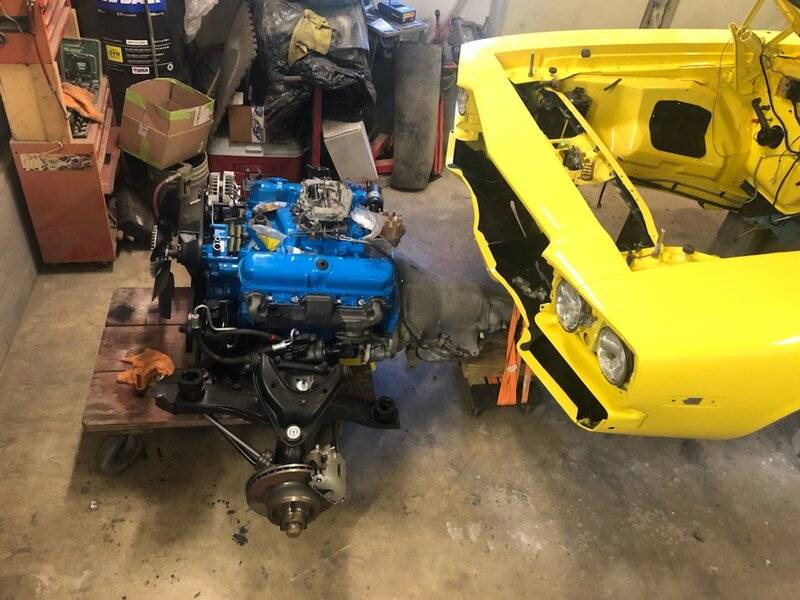

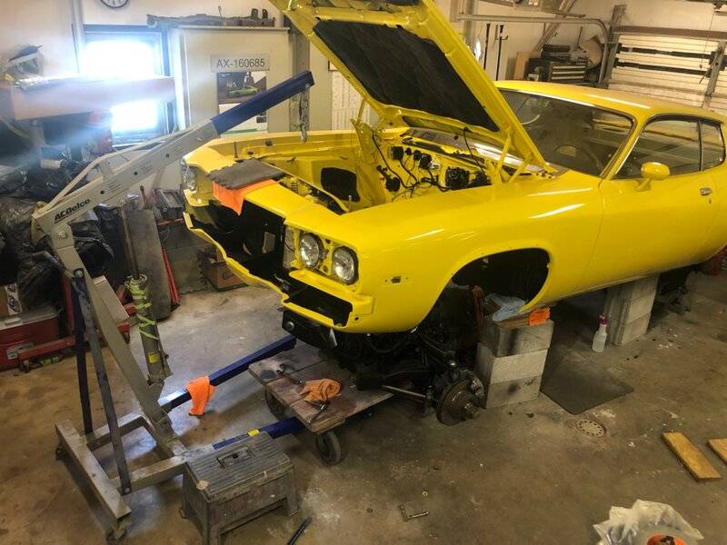

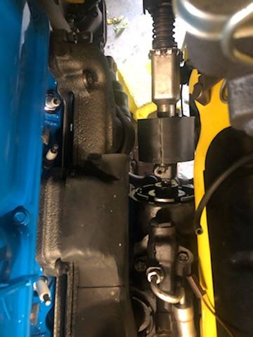

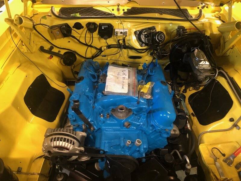

The engine finally found it's way home!
Lift the car up, roll the engine under it, and lower the car down (just like the factory). Well, kinda like the factory.
Back where it belongs

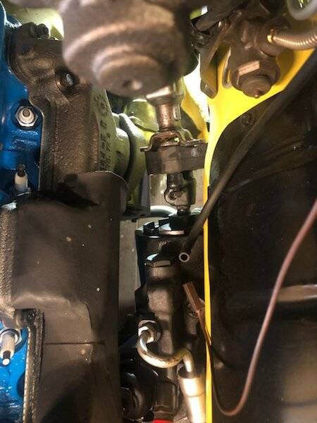

Now I need to put the steering coupling in.
Big fan of how the steering coupler turned out, not a fan of the PITA it is to install it! But it is in there now. I would not want to do this with the exhaust installed.

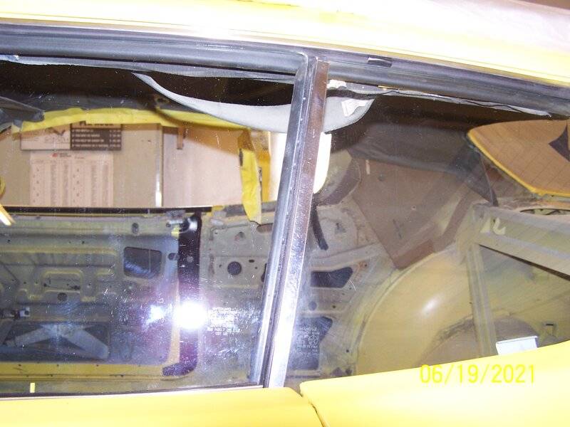

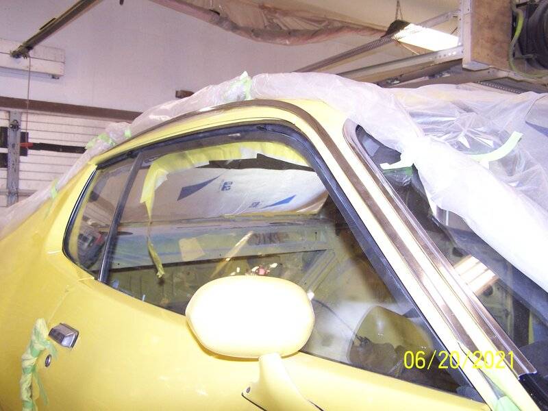

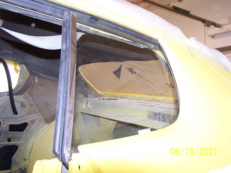

Switched back to my shop and put in the 1/4 glass and then set the window gaps.

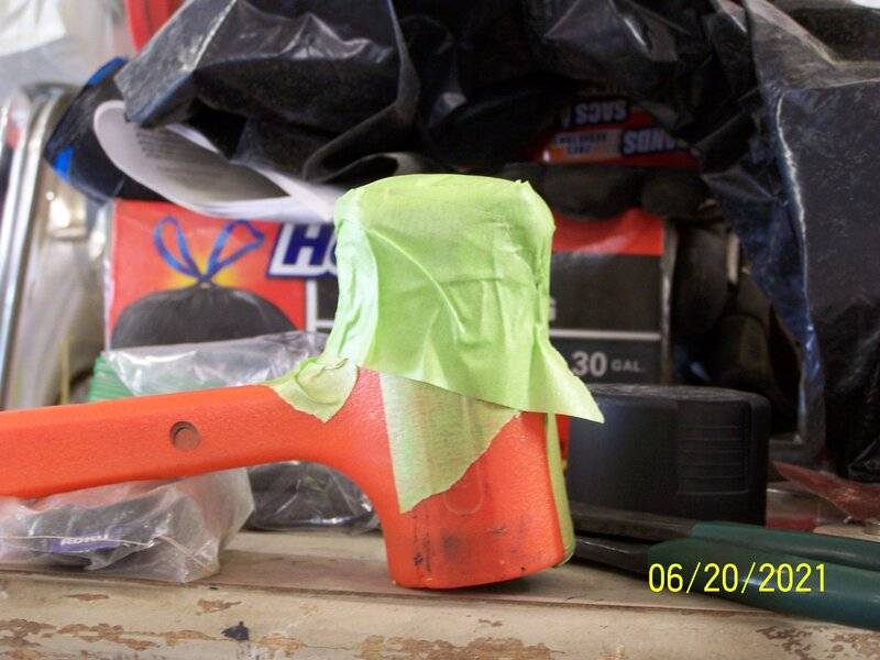

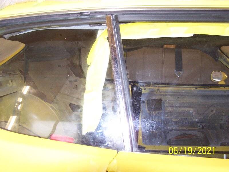

Only took a few minor adjustments to get the window to seal properly. Next, the wife and I installed the drip rail chrome strips using a taped up dead blow. Sorry, only took a pic of the right side.

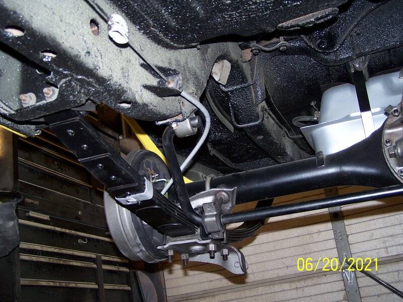

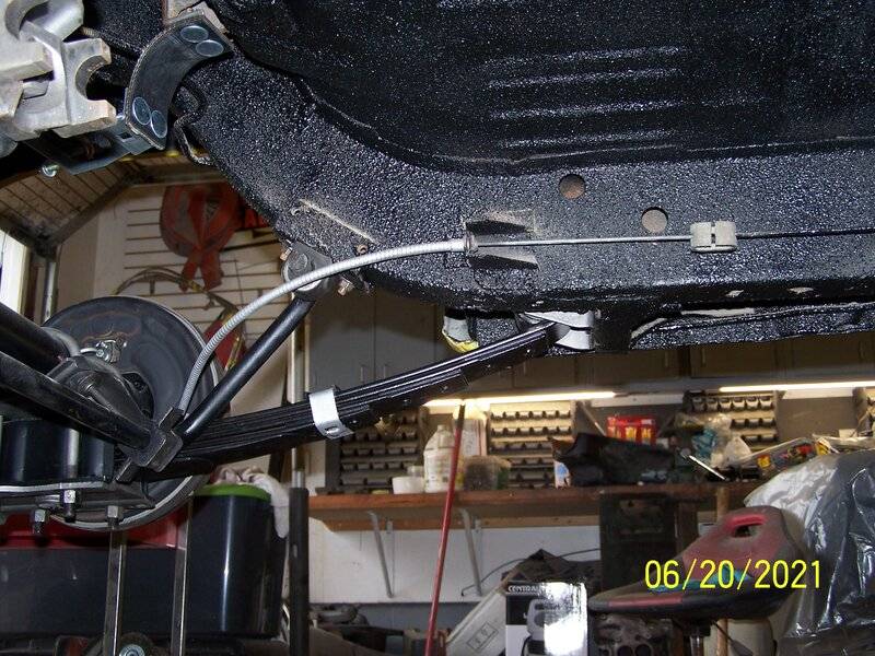

Got the rear sway bar bolted in and also took time the make sure all the E-Brake cables reached and worked.

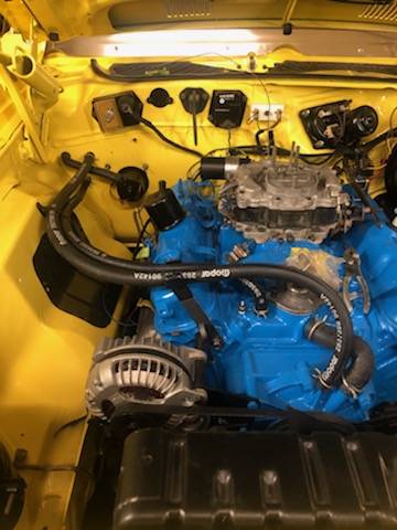

The heater hoses went in without a hitch:

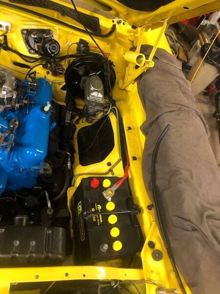

The FAKE Mopar battery is in (just couldn't swing the almost $400 for the real thing)

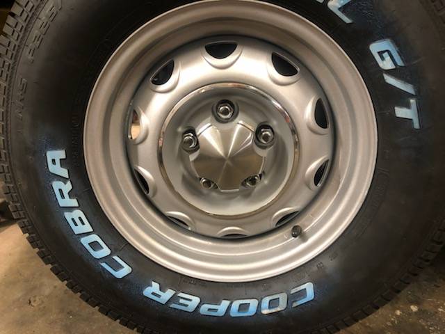

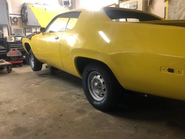

The wheels are on:
And she is just about on her own shoes:

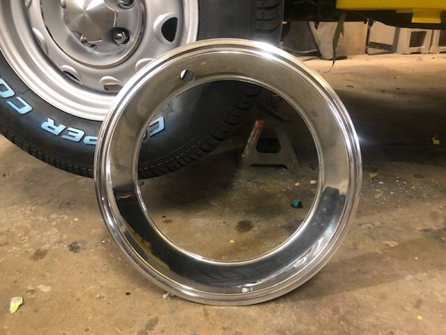

Slight problem with the trim rings:
They are brand new, and look great, problem is that they are for 15" wheels, not these original 14". Not really sure just how that happened.

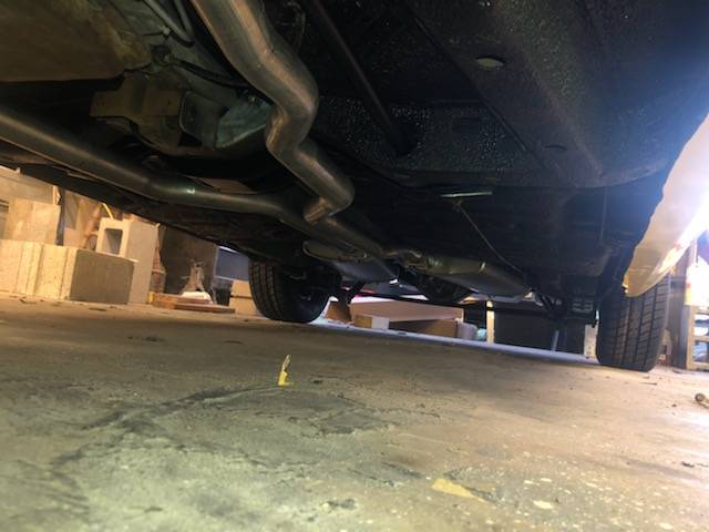

The exhaust is in (not the best pic).
But the tips were mixed up, one short and one long, in the same box.

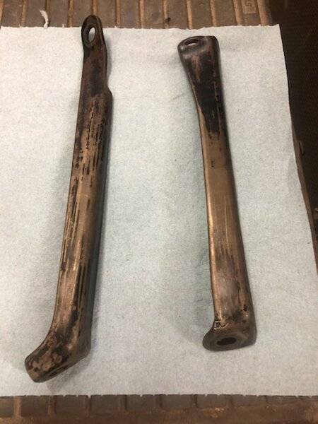

The better half is starting to believe I am more **** than she originally thought. I cleaned up the engine support brackets and once clean, I told her I was going to paint them. She just shook her head muttering that they were clean and so low to the ground no one would ever see them. I just smiled and hung them up for spraying.

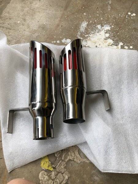

Who makes those tips?
I have what I believe is a very early set by Pypes but I have 2" exhaust on mine and not sure I want 2-2.5 adapters visible. IMO those tips are way too pretty to be tucked up under the valance that far.

YY1, not sure who actually makes them. I can only tell you where I got them from.
http://www.rpidesigns.com/
1971-1974 Mopar B-Body Long Red Slotted Exhaust Tips (Stainless Steel)
You might be long overdue for a change to some highly polished exhaust tips on your 71-74 B-Body. We are pleased to bring these stainless steel exhaust tips to market. These exhaust tips are sold as a pair, two tips and feature the correct 2.25" inlet as original. These were the slotted tips that were originally used for B-Body cars without resonators.
Why pay more for chrome that will rust out in a year or two? Buy these and never worry about changing them out again.
Sold as a pair
