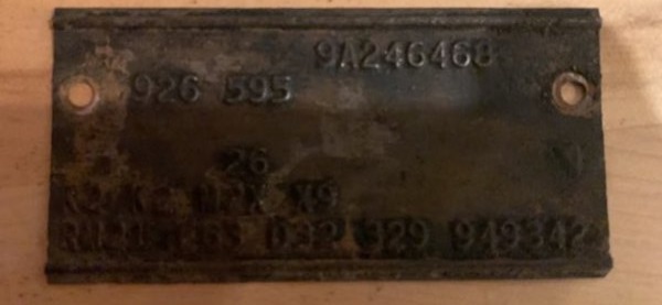

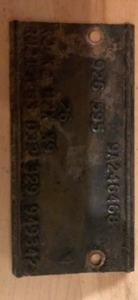

Does this decode as an A12 auto car. Looking at purchasing it on Sunday and I'm no expert on A12 cars. Car is in the registry as well. Just wanna make sure it's what it's supposed to be. Anything I should be aware of as red flags. Thansk guys

Am I missing something? I know those Lynch Rd. tags don’t have much info but I thought they had A12 on them.
It does seems to say E63 D32 (383/Auto), but it is very hard to read.
Tag is hard to read in the pic (and my poor eyesight doesn't help, but.... )
To be a real A12 car, the fifth digit of the Vin HAS to be M, and the middle of the tag, far left, HAS to have an A12 stamp.
The engine code on the fender tag will show 383, even on a real A12.
The three three- digit codes that decode as engine, rear, and trans are special to 6pack cars as well. If they aren't right, the cars not right.
All 6 pack cars started life as a 383 & the fender tag reflects that. The 5th digit in the VIN is what counts & it should be M.
OK. Thanks! I’m not as up on the ‘69 cars as much as the ‘70 V codes. That would be E87 followed by D21 on my ‘Cuda and Charger.
That.tag.is.suspicious. Even though it has the right spd for an early A12 (329) it's missing info found on my A12 tag. For instance, all gate info on the top line, and a third three-digit engine/rearend/trans code.
On the other hand.....mine is 426 date car, and might have more info on the tag. I would do LOTS more research before signing a check. I suggest the 69 roadrunner book (I'll remember the author and post it in a minute)
Wes Eisenschenks book. He's a member here I believe. I dont know his member name.
I bought his book full boat price at B&N. Worth every penny after ten minutes reading about my A12. (The $23 at B&N, not the $349 some ridiculous on-line retailer is asking!)

These were a late year build and the only other code available for a bee/rr was a hemi. They were built on a 383 platform, but the A12, the engine and rearend codes, told the assembly line guys what to put on the car.
To the O.P..... bend over. If it ain't got a Dana, it certainly ain't real, (easiest visual clue).

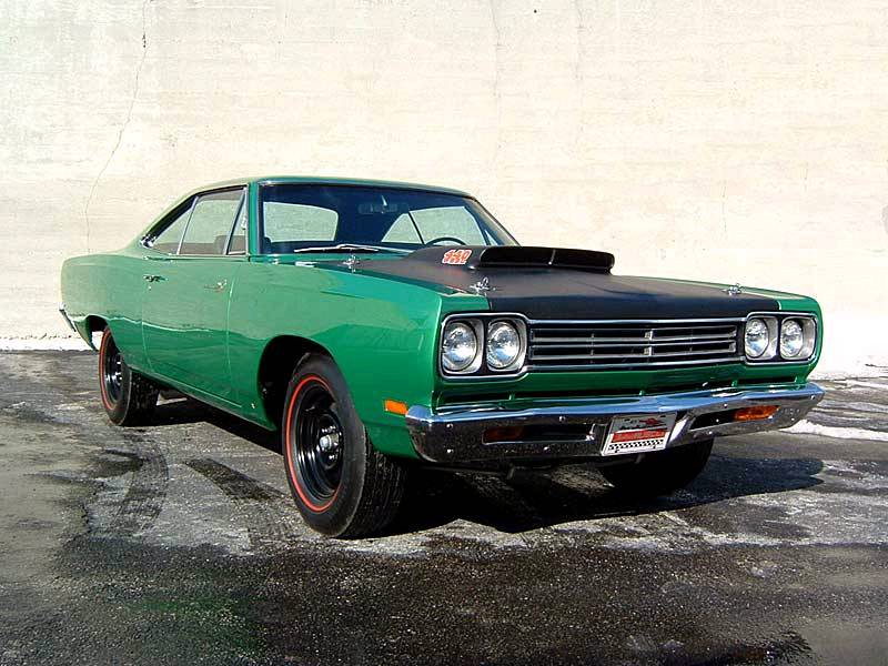

I believe this was the green. Rallye Green. I don’t think it made it to 1970, kind of like the Butterscotch that did reappear for ‘71.
I had a neighbor as a kid that had an A12 in that color. It looked just like this one.
