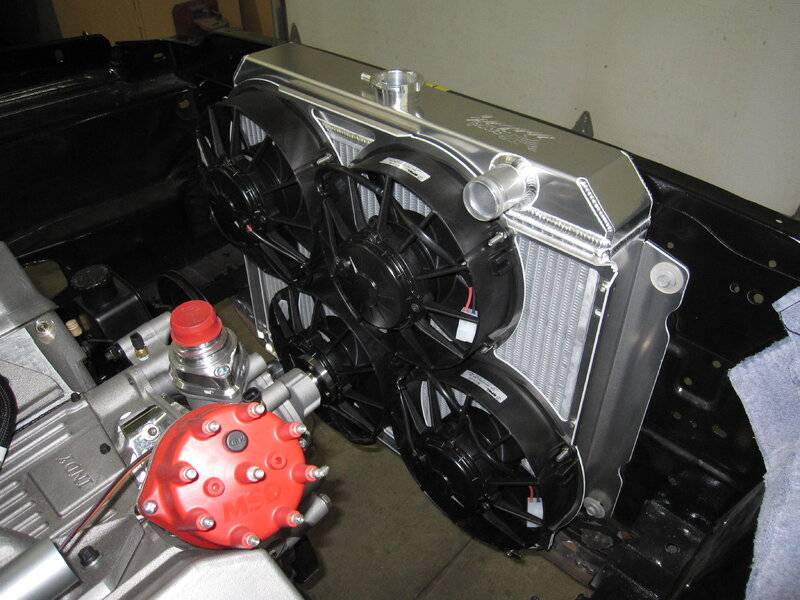

I had Wizard build me a 22" with fans that they told me would cool my 540 with A/C. Beautiful but pricey.
Mike
