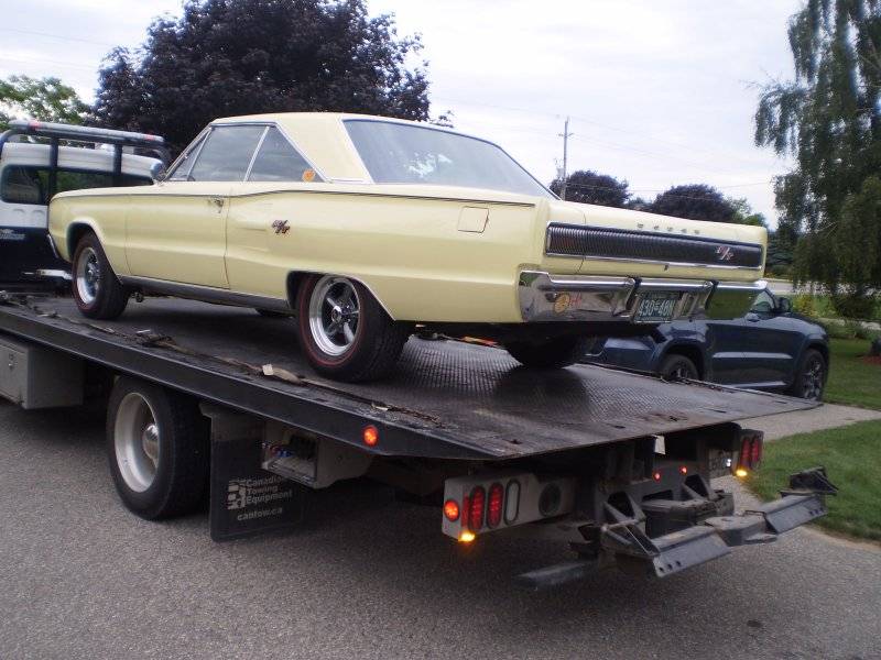

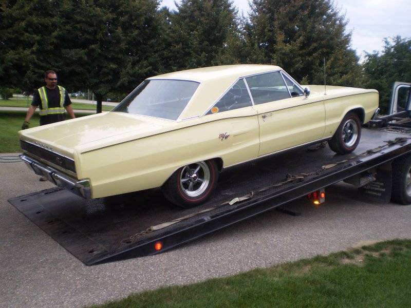

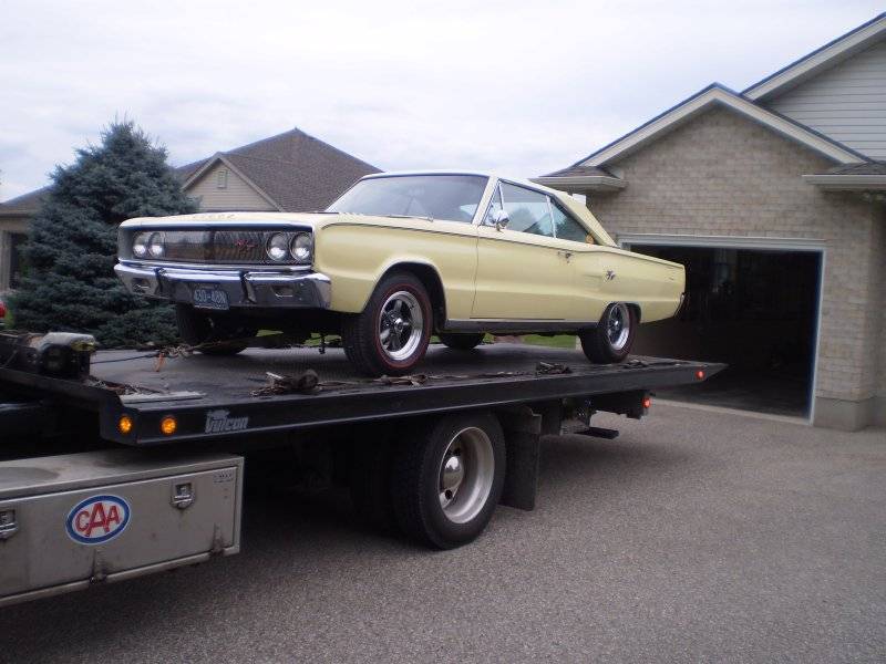

We went to a little local car show on Satuday. On the way home, I heard a distinctive "rat-a-tat-tat" from under the hood. I immediately pulled over and stopped to see what had happened. The long bolt that attaches the alternator to the head sheared off and slid out enough to touch the fan blade. No real damage, just a big inconvenience. A nice couple allowed me to back my car into their farm laneway to await a tow truck. CAA membership paid for the roll-back and 20 mile ride home. Now I have to try and get the broken piece out of the cylinder head. Hopefully, it does not have to come off.
I asked the operator if he could wait around the corner until after dark to unload at my place. He said my membership card would not cover that. Chev guy next door, and Ford guy across the road.

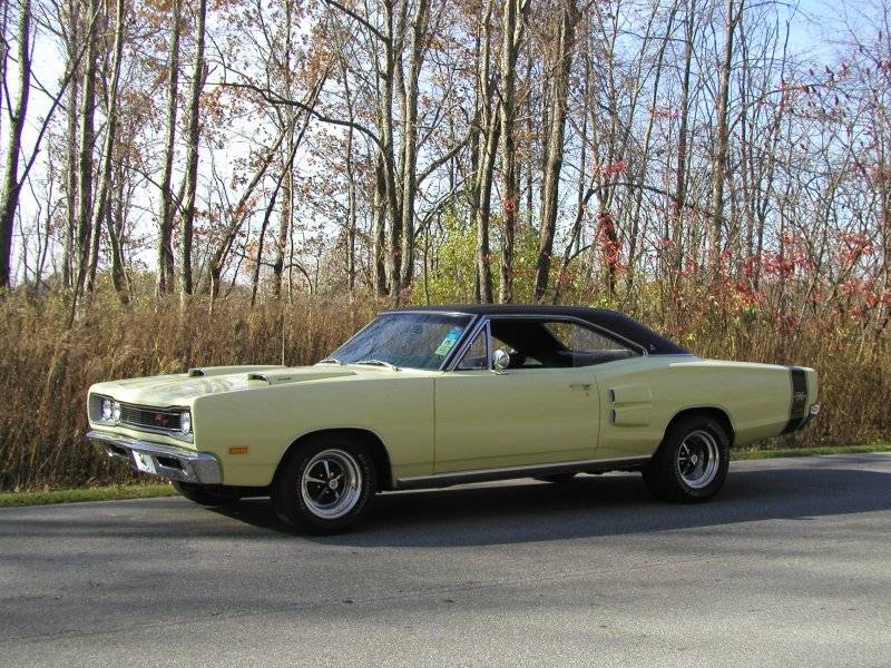

Very sharp lookin' '67 you've got there. We should get together for a cruise sometime! :lol:
I had the same recuring problem on a 340 years ago, I checked belt/pulley alignment, different belts and tried different tension on the alternator belt and it would randomly snap the bolt off. I tried grade 8 bolts and they sheared faster than the grade 5 bolts. Never did fix the problem but the grade 5 bolts would last months before breaking, and I eventually sold the car.
Sharp looking R/T yourself. I just think these cars are beautiful in light yellow. I bought a new Super Bee in 1969 and it looked similar to your R/T. My car was a "post" coupe and did not have a vinyl top. It was Sunfire Yellow with black stripe and black interior. Mine also had the side scoops and RamAir hood. I eventually came up with a fibreglass Six Pack hood and had Magnum 500's on it. It had 383, automatic and factory 3.91's on a Suregrip. Power disc brakes, and Hemi suspension, with 26" rad cooling package. It was $3650.00 out to the door. The dealership ordered it that way, and I bought it the same afternoon it came off the car transporter.
