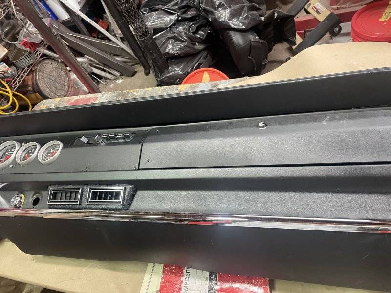

Any pros/cons for either. Also what are people using for dash frame black?

As far as the dash frame paint. I have a custom PPG mix made up with a texture agent added in.

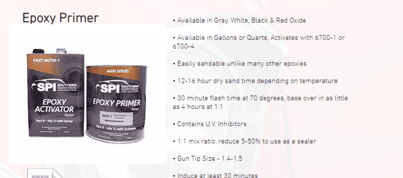

straight from the tech sheet:
4 hours of induction needed for maximum UV holdout if black epoxy is to be left uncoated.
Remove any internal gun strainers. Spray two wet coats for normal applications. For special projects such as restorations, spray one coat and let it flash 30 minutes or longer at 70 degrees or higher. Then spray a second coat for maximum corrosion protection. For frames we recommend three coats to make sure you do not have any thin spots as frames tend to be tougher to spray. You do not need to top-coat our epoxy on frames, wheel wells, firewalls, or suspension components
8ced3e_2e1da7dc5da34c94bb9c9704d8464b44.pdf (southernpolyurethanes.com)
Now thats cool and interesting ! I wonder if they have changed their formula ? The first time I used it , I read threw all the literature and even talked about it with my paint rep . I didn't see anything about the UV inhibitor information.
But as you have provided , there it is !

Just ordered SPI will be here in two days. And will look into the provided dash color info. Thanks Everyone!
