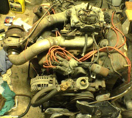

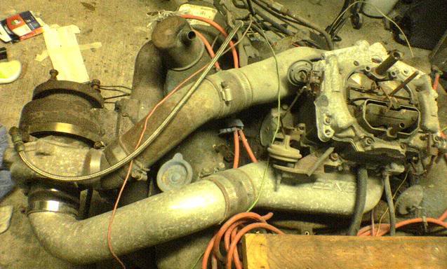

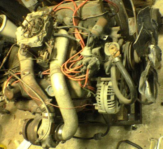

A company back in the 70' made a turbo set up for 440 RV's,I have pic's of the actual set up as well as info from the State of California Air resources board...Check it out it's a cool but also dry read.
http://arb.ca.gov/msprog/aftermkt/devices/eo/D-90.pdf

Wow... that is pretty cool info 74sundance. I don't know how on Earth you found that. Interesting that they were using a turbo with water injection back in 1979 for an RV (and taking the water right from the RV water tank... what a great idea).
That turbo converter box that they describe for the carb is pretty much what I was thinking about making... might be able to find one on an old RV somewhere and save lots of time. ???
I still don't know if it would be better to go that way or with a blow-through carb set up... they couldn't use any sort of blow off valve with the draw-through set up, they had to control the boost with restriction on the turbo, which seems like it would inhibit some of the performance. I also don't know if I like the idea of compressed gas/air mix in a tube on top of the engine... the thing could blow up if it ever had a backfire, and you probably wouldn't want to run this mix through an intercooler either, if nothing else, the fuel would condense out of it.
Very good information about all the things that they did to run the 440 with turbos though. Thanks for posting that. :)
No prob,I thought a lot of people would like it. I find lot's of people wanting info on how to turbo a 440.One bad thing about that set up is it's a wet turbo so it's not the greatest for performance, a dry turbo is much more efficient.
