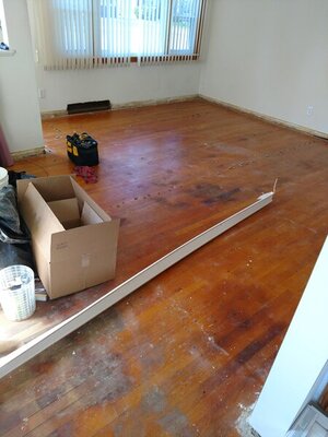

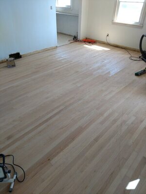

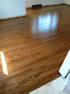

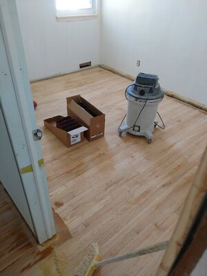

I did a huge job on a house I flipped right after my retirement. I used water based. It certainly is easier to work with, but does not last. Go with oil. (The pictures are out of order.)

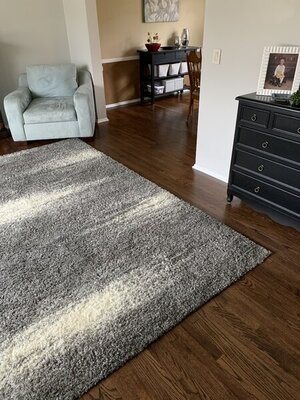

Heres ours done last month, pad sander yes. This time we hired out, $1,900, with oil base

View attachment 1269841 View attachment 1269842 View attachment 1269843 View attachment 1269844
