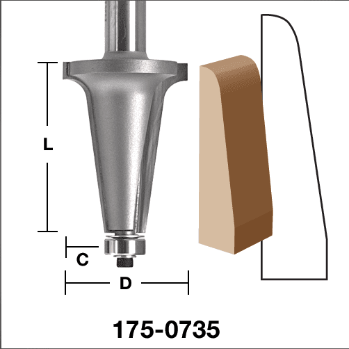

...but I did find this-

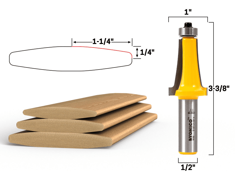

and this-

That 175-0735 is probably the closest you will find for a router bit. As stated above they use huge planing machines to shape the stock on typical mouldings.

8592 that I posted above is also very close but only comes in 1/2" shank.
Closer than the other one I posted.

shaft is 1/2" - should give you an idea of the cutter size. This is about as big as you're gonna find in a router bit. If you need bigger, consider using a tablesaw with an good carbide blade then a sander. Should turn out pretty good with a soft wood like cedar.

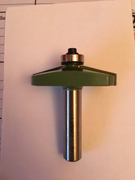

Yes I have a table but the router is fixed 1/4" so looking at a new convertible fixed/plunge, adjustable speed, back EMF RPM stabilized upgrade.
The bit pictured above is the opposite of what I need.

I have since found that a "shutter" bit is real close and might be a good plan B.
The difference is that it leaves 1/4" on the top of the piece.
My sample baseboard only has 1/8"
That might be a livable compromise.

If you're making shutters, you're running the stock on edge, then turning it over and running it on the 3/8" edge again, reducing it to 1/8"!
...and it turns out my first thoughts on the shutter bit were correct.
It's going to leave more of the top edge than I want but the profile is almost dead on correct.
