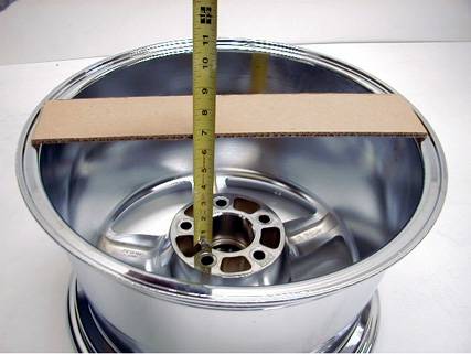

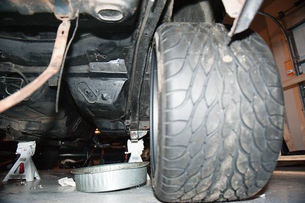

its really not that hard to figure out, start with your stock rims,
1.what off set is it now
2how much space do you have on the inner wheel well's
