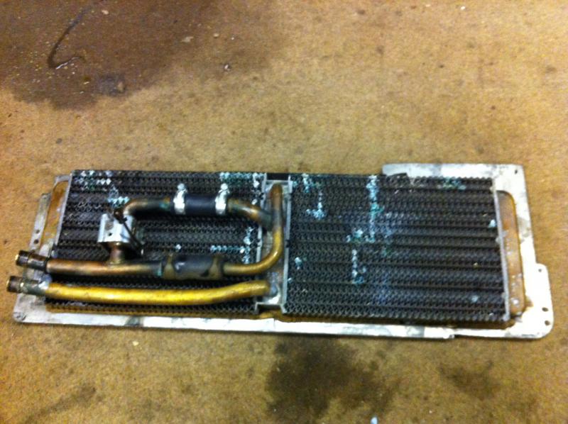

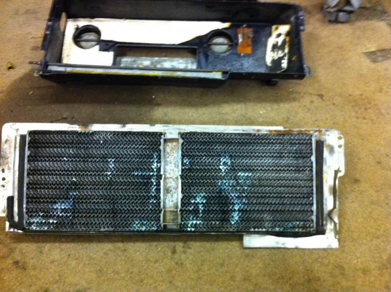

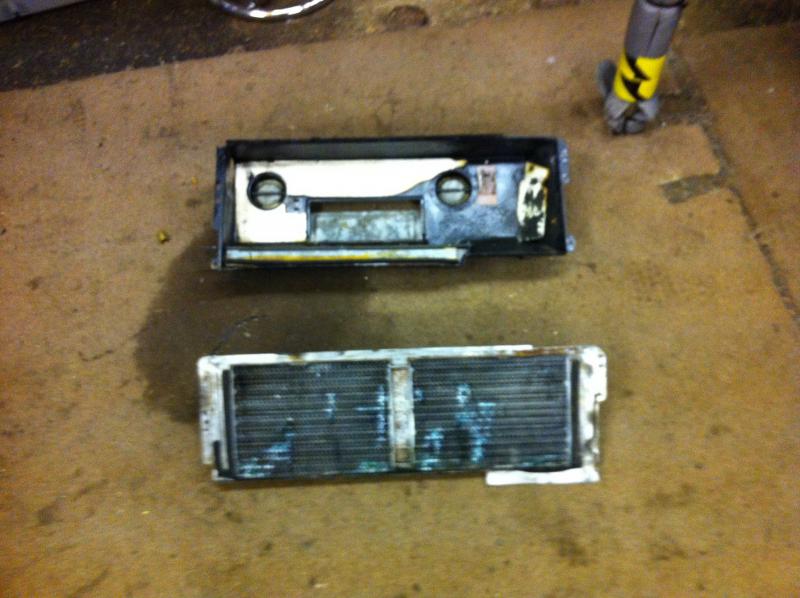

Well after a few hours and a visit to my friend Steve the jobs all done and completed.
I took the old core to Steve who repairs stuff like that and yes it was toast but to my suprise he pulled out a brand new core that fitted the original AC housing. So no need to change that.
It's slight smaller and the hose outlets are In the wrong locations but with some modifications I knew I could get it to fit without it being noticeable. The Core was fitted and plumbed in and working within a day.
Far from the easiest job I've ever had to do on the car but the relief when it was all back together again was priceless.
Normally I like to replace parts on the car with original correct items, but on this occasion you'd never know what core was in there and there are no visible signs or giveaways and that I can live with. Plus it only worked out at £50 or $65 approx for the core.
