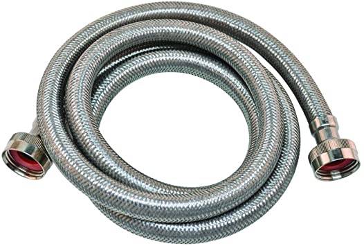

I was just at Earle's Service Shop in Indianapolis last week and bought some #12 braided hose. It was $11.50 a foot. So the size needed for a fuel line would be a lot less expensive. I don't care who Uncle Tony is there is no way in Hell I am using washing machine water hose on a fuel line, but it's your car and when it all goes South send Uncle Tony the bill.

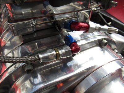

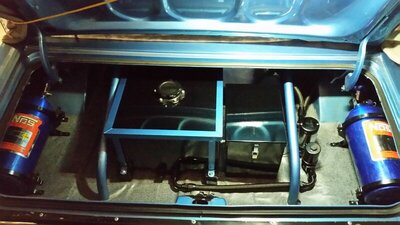

I went with the black nylon AN hose and fittings for everything on my car. So much easier to work with. No pricked fingers and so much lighter.
Yes, they have fittings for the manufacturer's specific hose. They also have it in a black coated PTFE hose and fittings which all of MI nitrous lines are. I used almost all Fragola. Great people and company to deal with.
I was gonna ask if teflon was available. Gonna try the nylon braid on the light car, wont make any difference on my pig.
