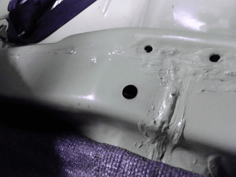

These are holes I found on the ledge that the front of the seat cushion sits on on my '73 RR project:
I can't find anything in my collection of parts from the car that looks like it could go there, both over and under the floor. I need to figure out what to do with these holes because I obviously don't want to just leave them so water can get in if this car gets driven in the rain, which I hope never happens. I'm thinking if there isn't anything that really needs to be there I'll just weld little patches in them.

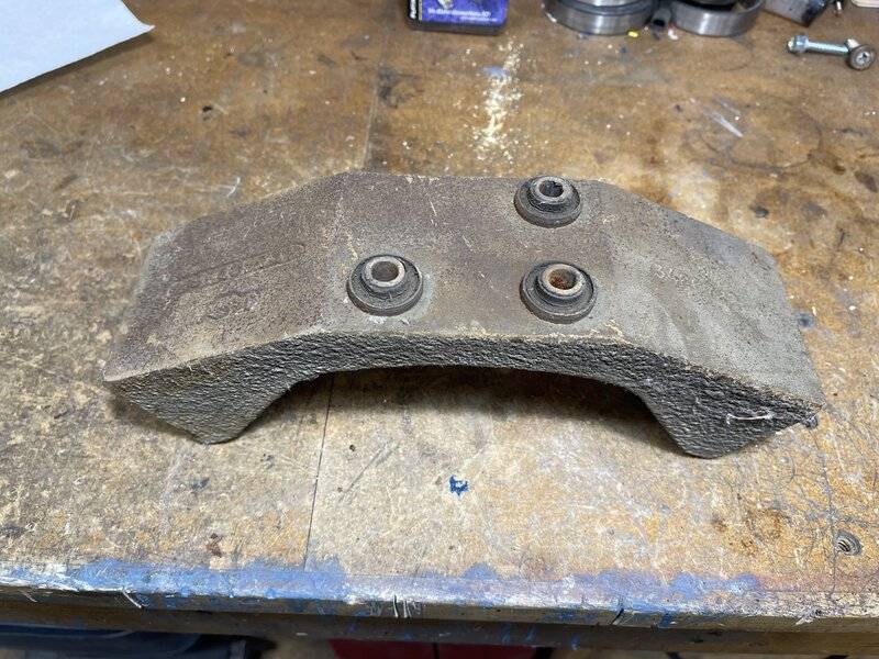

My 73 parts car had the dampening weight. I think I still have it. I assume its to reduce floor vibrations. Its a heavy thing. I'd weld up the holes & move on.
Anyone have a picture of the dampening weight? I'm surprised I haven't run across it. This car came with a trunk-full of parts when I got it. Someone had started fixing it up and made a real mess of things in the process: no organization or labeling of parts whatsoever. Hard telling if the weight is there or not, but like you say if it isn't I'll just weld the holes shut and not worry about.
Thanks for the input.

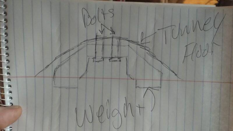

It's a big chunk of cast iron that sort of follows the curve of the tunnel & curves to allow clearance for the driveshaft.... Lotta them got tossed cause noone understood what it's there for & it's just un-needed weight..
A weight to dampen vibration....

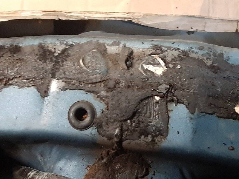

The weight must have been a 73 only item as both of my 74 Chargers have those holes but no weight. Back two holes are filled with seam sealer and then black sealer smeared over them. The front hole has a rubber plug in it. Both cars done identical.

That might have been what was done with this car because I haven't seen anything resembling a concave shaped weight in the parts that came with this car.
Looks kinda like this...

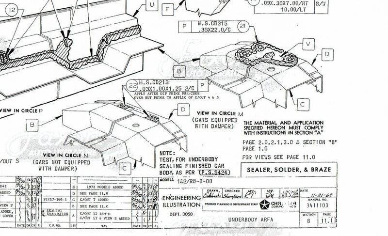

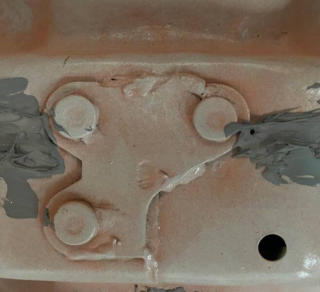

Not all cars had them, typically small block automatics. If it came with the weight there would have been a stud plate welded and seam sealed to the floor on the inside, studs protruding down through bushings in the weight. Clearly the stud plate is missing, good indication that car never had it. Seal the holes up.
My 71 has one. 383 HP Auto car.
Edit: pic of the plate from the top.
Guess my '74 SE Brougham (400 four barrel with 727) got left out of that one. The two back holes are full of body filler/seam sealer and the front hole has a body plug installed.
