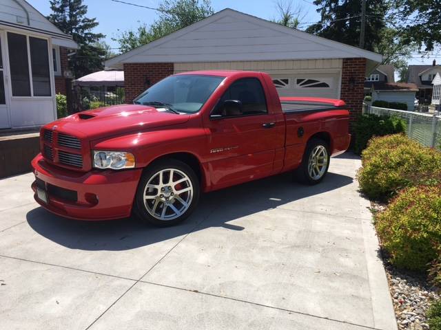

    Joe, what size tires do you have on your car? Looks good. Was thinking about getting those wheels but in 17”

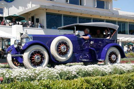

            Rubber is naturally an OFF white color?
            That would be really strange to see tires in the natural color.
