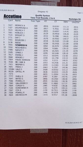

Car still struggling at 60 ft. Ran all 3 qualifiers within .01
