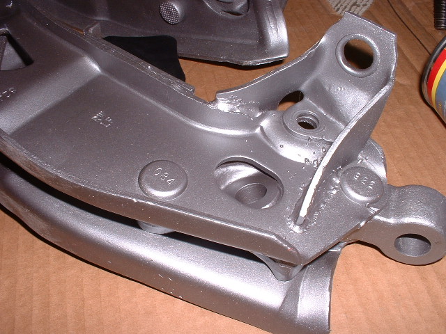

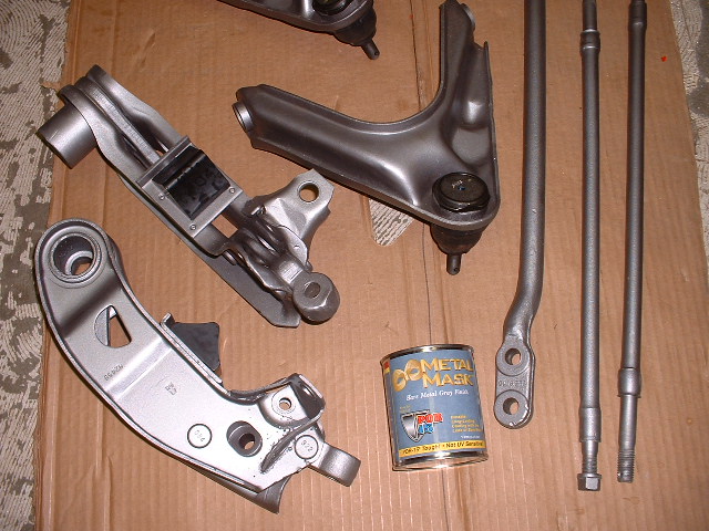

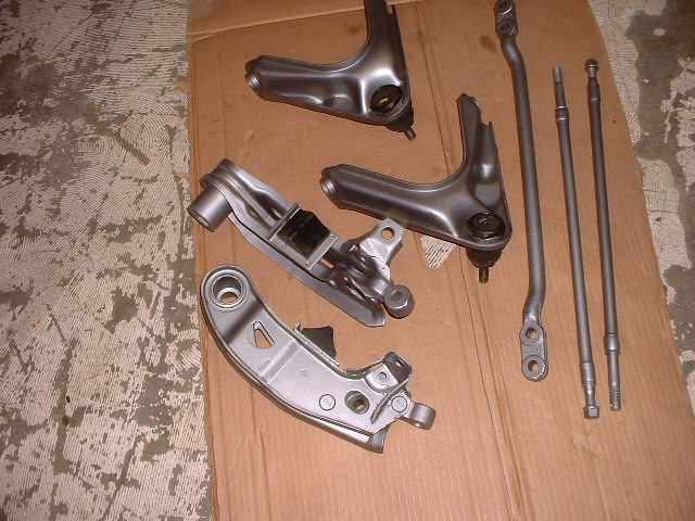

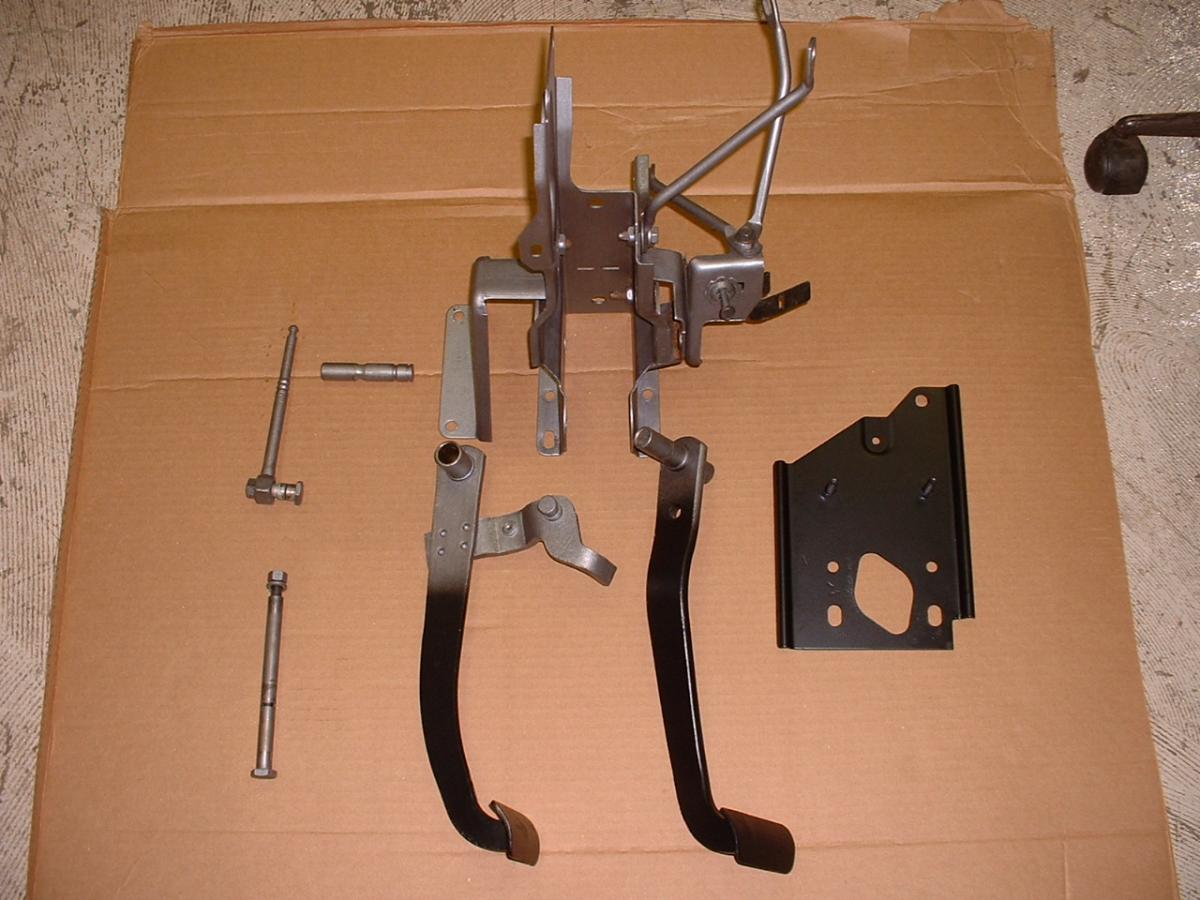

I ended up doing pretty much what you just said except I painted the bare steel parts with POR 15 Metal Mask (the stuff that looks like bare steel). So far the control arms, center link and the strut rods have the bare look. Basically everything that was really rusty told me it was never painted so I acted accordingly. I'm not going the full 100 point show route, but since I have to do something to protect from the elements I thought I'd get it close.

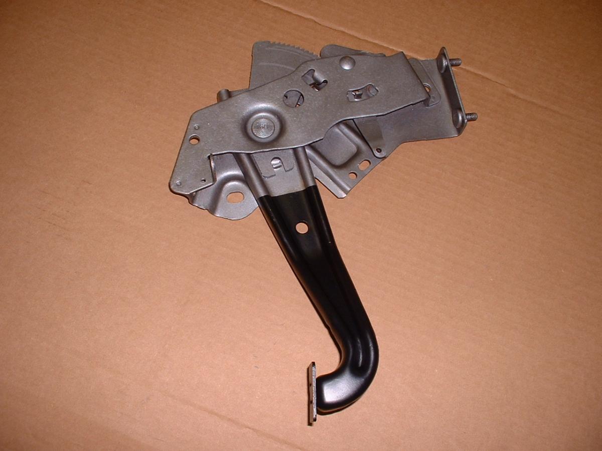

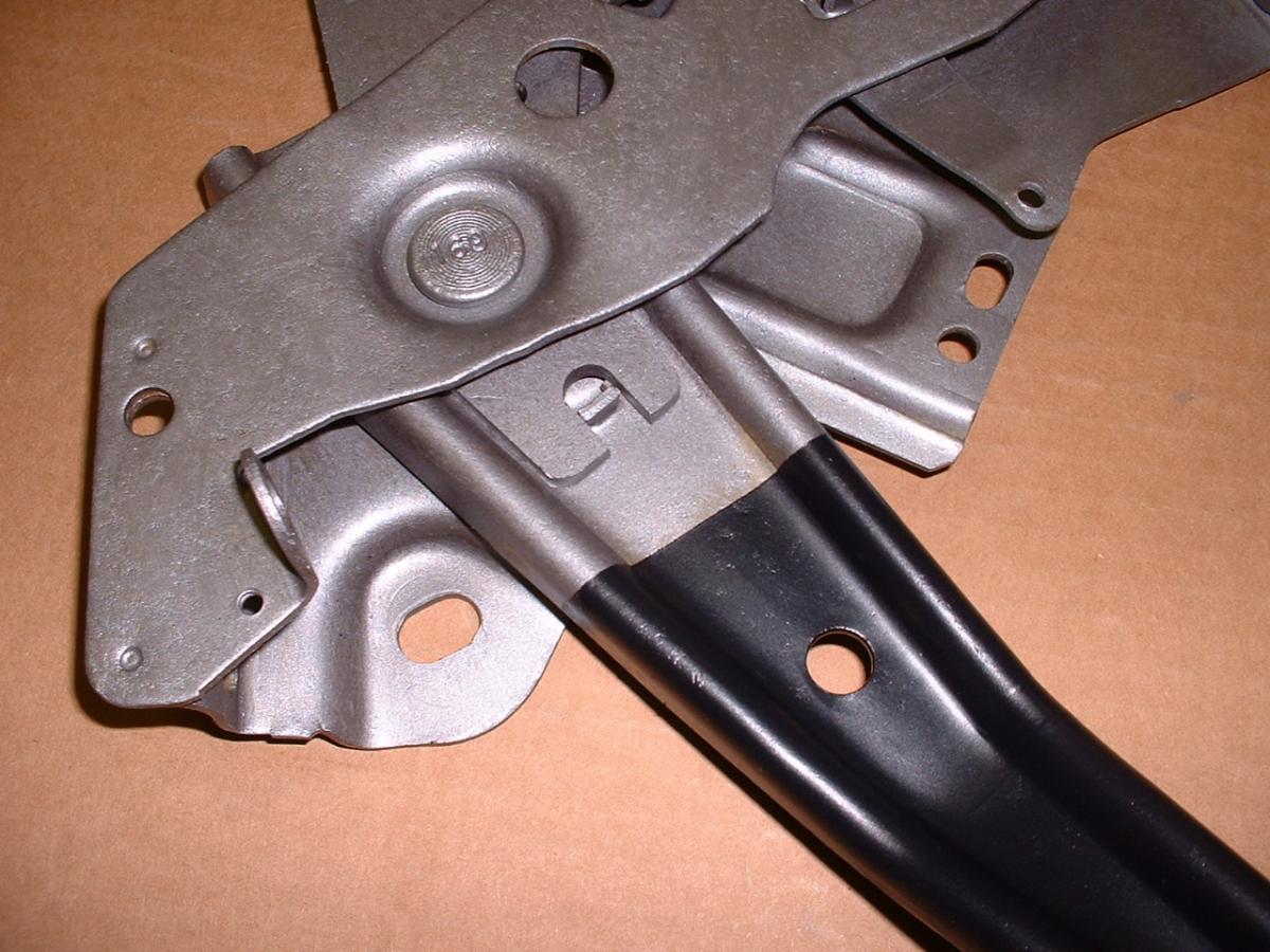

I also painted the end of the steering shaft and the coupler with the metal mask. I did my pedal cluster with support and parking brake assy too. I was happy with the way it came out.
POR makes some very nice products also and your parts came out looking REALLY nice, so it looks like you're all set. I went with the powder coating on my car because it's a very durable coating and it also looks great for a long time. Either way, as long as the bare metal parts are protected from the elements, that's all that matters. :yes::grin:
Richard
I like what you have done and think thats the way to go.

Here are the suspension parts. I just reduced the paint with the POR solvent, cleaned and treated the parts per instructions and sprayed with a $9.00 gun I bought at a swap meet. The pedals were my first attempt using the coating and I used a brush to apply it. The brush marks are kind of a pain to deal with so I recommend spraying.

Your parts look VERY nice! :yes: The only thing to find out now, is how well the por paint holds up when the car is back on the road terrorizing the Chevy's, Ford's and imports in your neighborhood! :D
Richard
Exactly!!
I don't build garage queens and I look at rock chips as tiny badges of honor (so long as they are small). I too am hoping for the best on the por stuff. I can say this, I dropped one of the control arms onto the concrete floor the other day and it didn't chip. I still have to press in the bushings, so I'll see what that does to the paint.

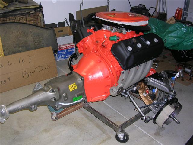

Thanks, yours too!! I like how you did the trans finish - including the number. What is that?

That is the rack number that is on the broadcast sheet, they pull the type of tranny that way. When I cleaned the tranny off I found all the markings you see, Ive been told I need to mess up the green a little it didnt look that good off the rack. The paint on the trans is Aervoe steel blast engine paint.

That looks like it is ready to be installed from under the car just as it was done from the factory. Certainly the easiest, fastest way provided you have two guys to do it, one on each side as it goes up into the engine compartment. That is the way I did it and the guy helping me did not have a clue about things mechanical.
From the bottom is the best - it is a one man job (if you have a lift) to get a Hemi in a B or E body... wanna guess how I know that ? lol
