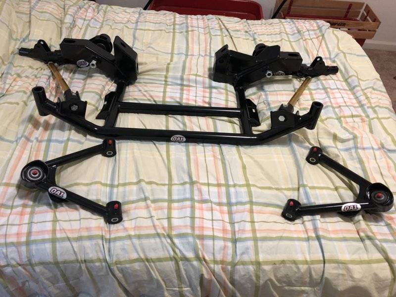

I understand what you’re saying. The main reason I bought my qa1 suspension was because I didn’t want to have to degrease and rebuild all the stock stuff, plus a little bit of a performance upgrade. It’s definitely cheaper to rebuild your existing parts though.
