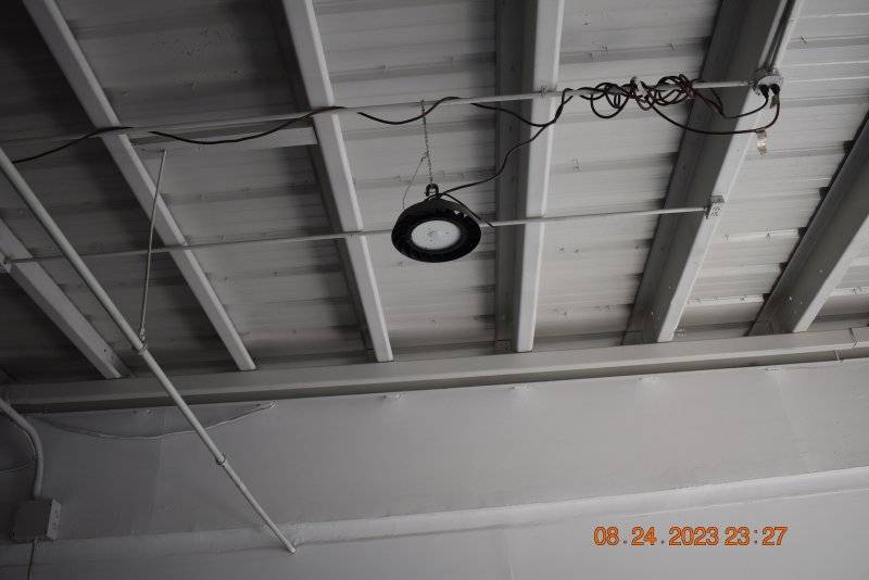

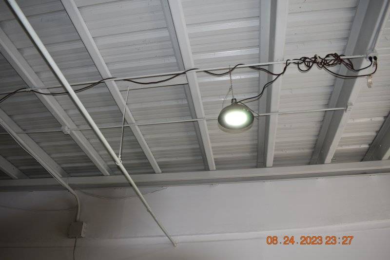

I would suggest the HID high bay style LED fixtures instead of the long tube. I use 150w which only cost about $75 ea. Mounted at 12ft they cast a 360 degree very bright light in about a 30ft circular pattern , you can't look at them directly. 3 would light up your place brightly. I took a picture but am having trouble with the timne to download to my email. The camera takes away much of the brightness.
