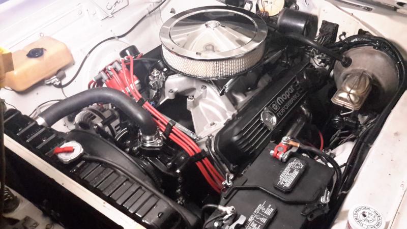

      I'm likely to go with this in both classic cars, my Roadrunner and GTO. Both are getting new Cold Case radiators and new water pumps as part of the changeover to the Wraptor serpentine system, and both are getting Vintage Air.
      Seems like now is a good time to change.
