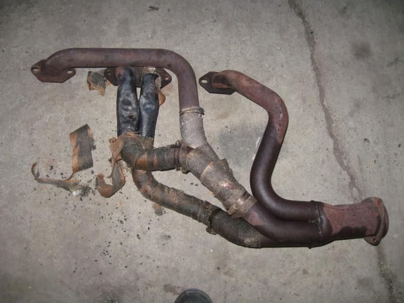

Can't help you too much. I replaced the headers on my Charger 3 or 4 years ago. First set rusted out, but I had them wrapped with wrap. They were over 15 years old, cheap Headmans with thin flanges but never had a leak. Did have to smash them around to fit around the steering gear.
Replaced them with Hooker Competition's I got them used from my cousin. He had them on a '76 Charger with a 400, had them on for one summer, they leaked and took them off. Figured for free I could try them on my car. Drivers side flange was warped so I straightened it and put them on. Also cut the flange in two places so each tube or set of tubes could "float". I used Ultra Copper on both sides of the gaskets. No leaks. Firm believer in Ultra Copper on header gaskets.
