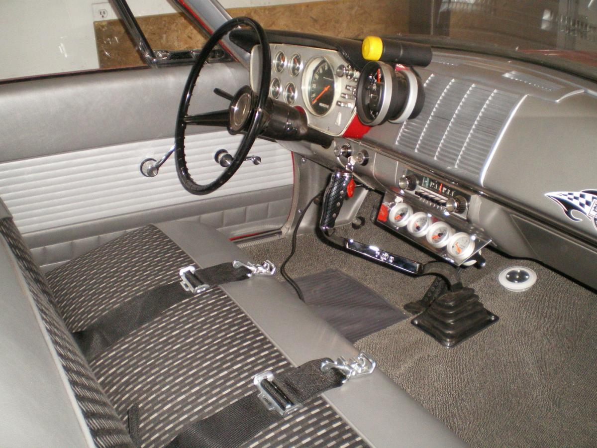

I love your Pistol Grip shifter!!! Looks close to the dash? A knuckle buster?

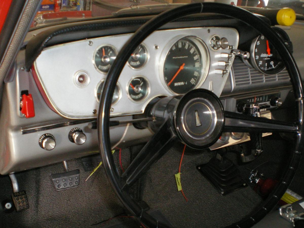

Thank you, I check and it was the dimmer switch. Now that I fixed that, Im still in need of help. My dash gauges work but not the dash light. I found this on Ebay, PANELESCENT dash light driver unit. Ive never heard of one so is this what could be the problem? If its a light switch where do I get one?
