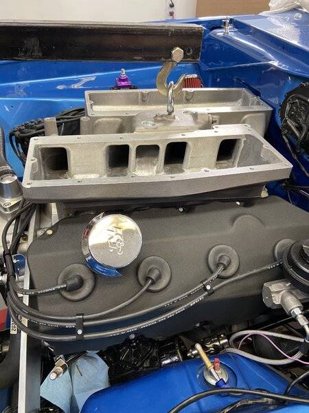

Thanks for the info on the gasket. I think that I’ll continue to pop the plenum tops off once in a while. Sure a lot easier than lifting that intake off!
Although this wasn’t too bad at all.

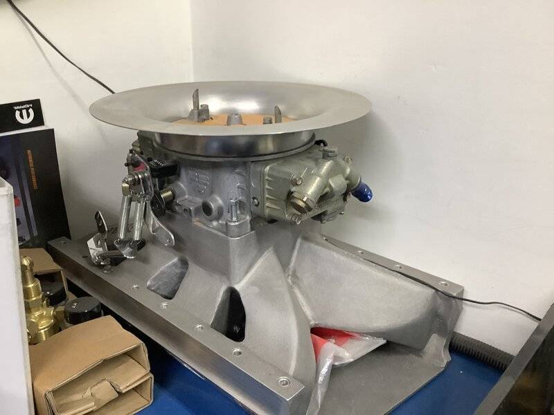

I was thoroughly impressed with my Barton intake. I did spend lots of time in it however. It sure worked like a charm with the 1250 Dominator on the dyno. Good numbers on 91 octane pump gas.

Really Fine intakes there, malex !! ...On a stock bore/stroke/head cfm size motor,...which of those carb/intake combo produces better 3500--6500 rpm dyno numbers ??
Btw,.... Couldn't miss the hoist hook on your X--ram,......You Don't Really hoist a hemi by the Intake ......do you ???
I was setting the cross ram down into place when I swapped out the Barton.
In my opinion I’d say the single is the way for you to go, although there’s others here with much more experience than I have. For my application the cross ram was a must for my build when it came along.
