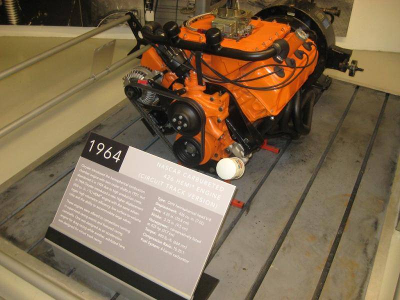

tried the vintage "Nascar" Edelbrock RR1 Rat Roaster intake
in single 4bbl 4150/4160 (?) 1964 to (1967-ish ?)
Like Richard Petty & Cotton ran
or later a Dominator top
Engine 426ci Hemi Edelbrock RR1 Rat Roaster 4bbl 1964 Plymouth NASCAR Engine.jpg

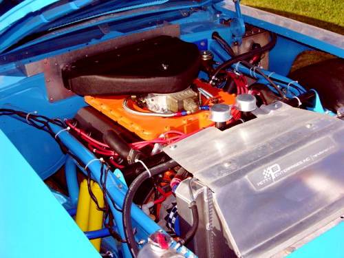

Buddy Baker-Cotton RR1 combo
Engine 426ci Hemi Edelbrock RR1 Rat Roaster 4bbl Nascar Buddy Bakers-Cotton owens #6 (1.jpg
Engine 426ci Hemi Edelbrock RR1 Rat Roaster Nascar Buddy Bakers-Cotton owens #6.jpg

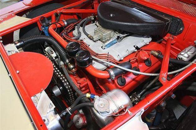

RPM Richard Petty's combo
goofy carb bowl (?)
Engine 426ci Hemi Edelbrock RR1 Rat Roaster 4bbl Nascar Petty's Engine bay.jpg

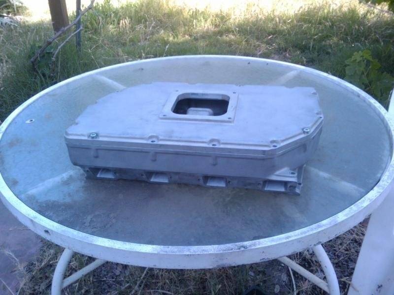

single dominator top, seen on FABO

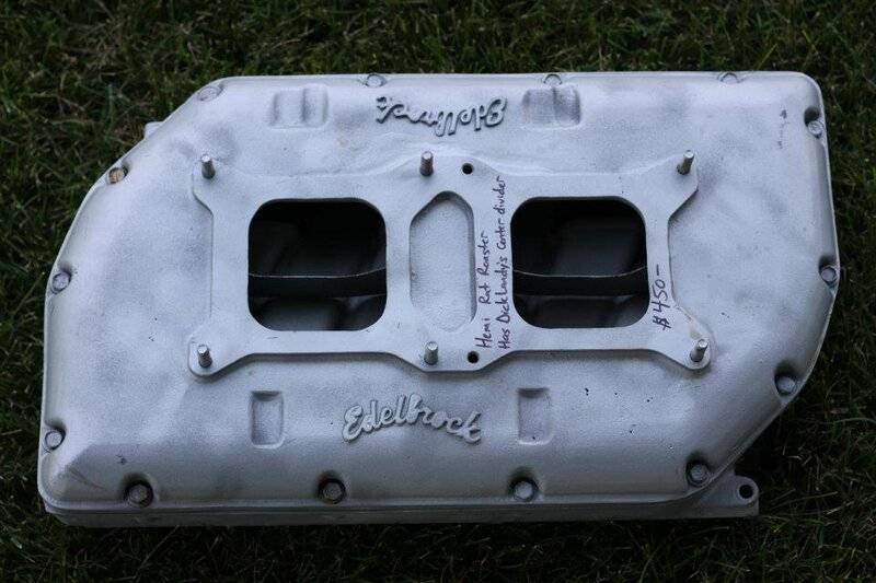

or a 2x4bbl inline, like Dick Landy's 1970 Charger ran
Intake 426ci Hemi Edelbrock RR1 Rat Roaster inline 2x4bbl Dick Landy's 70 Charger RT.jpg
