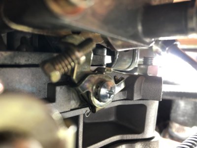

Ok I think I actually have the circuit but don’t see how it works as set up on my carb. The spring looks like its in the wrong direction possibly? As the spring is holding the can back not forward. And the choke appears to push the cam back. So when off choke or on there is no change to the cam position. This can’t be set up correctly.

Thanks Ron I believe what I have is the smooth cam fast idle set up but it does not engage when I pull the choke out. So I am trying to figure out why. Can you confirm that what I have in the pictures I took is complete and set up correctly? To me the fast idle cam is *** backwards as the spring tension is opposite like the cam is in wrong. The choke does not engage the cam at all. Adjustment maybe?

The arm with the screw through it looks like it is the long version. The short is probably what you need. Long and short refers to the length from the 90* bend the the center of the screw. If it was shorter would it contact the cam?

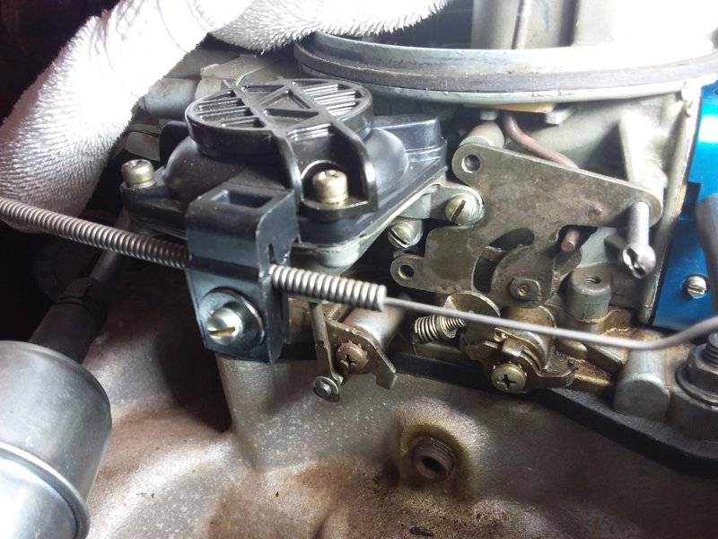

The pin that is sticking out of the cam and control lever assembly has to fit underneath the lever you can see in the crescent shaped slot. If it goes above it, it will not work. The choke is spring loaded closed as it sits in the picture. To put it together properly you have to fight the spring tension.
My spring tension seems to be be in the direction of pushing the high speed idle adjuster towards the back of the car. This looks to be in the same direction as the cam would want to push it as the choke in engaged. Seems backwards to me as I originally indicated. So the choke cam never engages the fast idle linkage!
Should moving the high speed idle linkage move the main throttle linkage at all off its idle point as it comes on?
I did not see the spring in your picture above and wonder if mine is not correct and needs to be set up differently. Here is a shot of mine.
