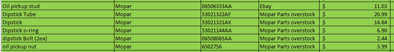

I used a similar pan from Weiand (made by Holley) 5051WND. Here is what I used for the pickup nut and dipstick. not sure about the deflector as my pan required the use of an OEM gasket w/windage tray.
Dipstick Tube Mopar 53021322AF $20.99
Dipstick Mopar 53021321AK $14.64
Dipstick o-ring Mopar 53021144AA $6.90
dipstick Bolt (2ea) Mopar 06508065AA $2.44.
oil pickup nut Mopar 6502756 $3.99
This tube was from a ram and goes into the block bout required a little bending and relocation of the mount tab to make it look less dumb. its a tad on the long side. Ill see if i have a picture.
