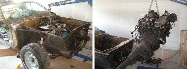

Like others have noted, it will require tilting the whole she-bang out at an OBSCENE angle,
but folks been doing it for decades now, myself included.
Did the last one by myself....
Don't do that.

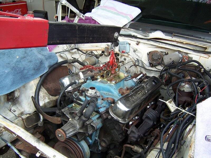

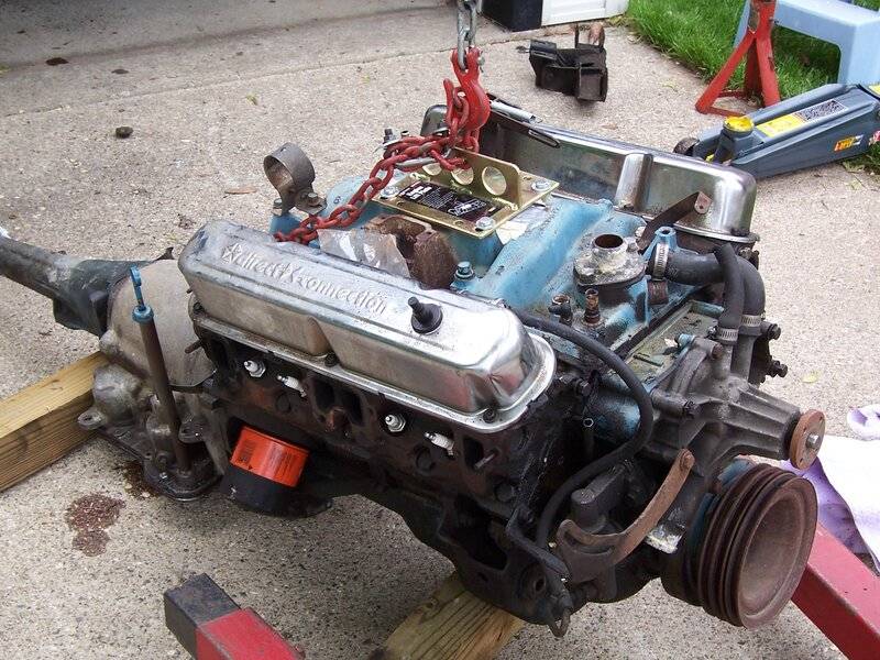

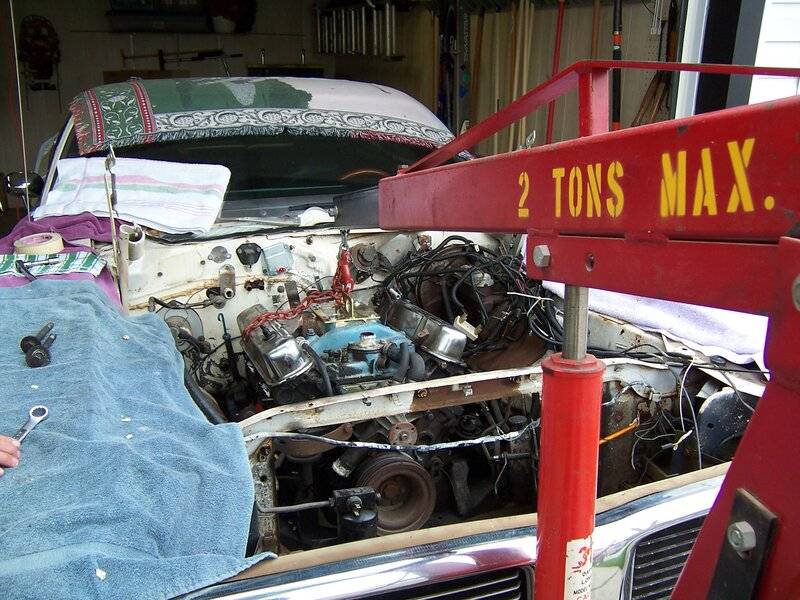

Yes you can pull both out. I did on my 73 Charger. Just jacked up the car a few inches for extra clearance and they came out with no problem.
