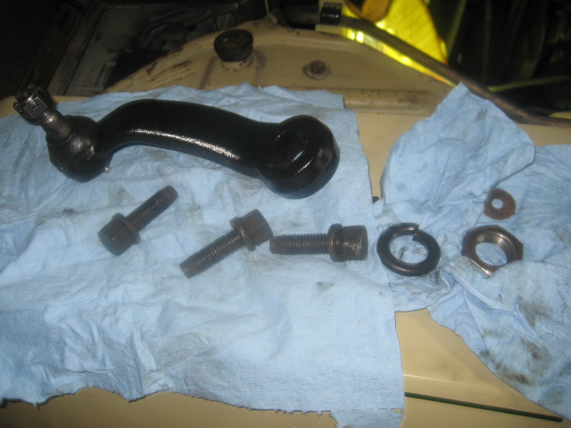

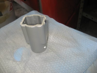

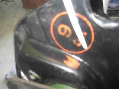

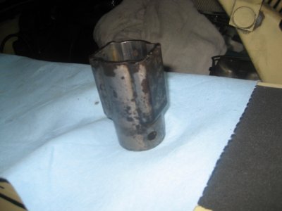

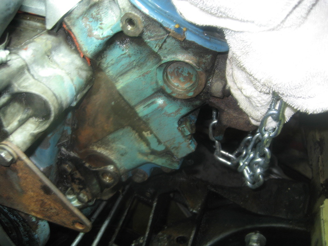

I've been doing a 67 coronet takeing pictures as I go... I hope you marked the steering shaft and gear box Pittman arm etc when the weel was straight up and looking from the box along the shaft there are reference points along the way that line up... I use white out to mark every thing then freshen the marks after I paint stuff... I've done my last alignment with the steering one or two turn off
