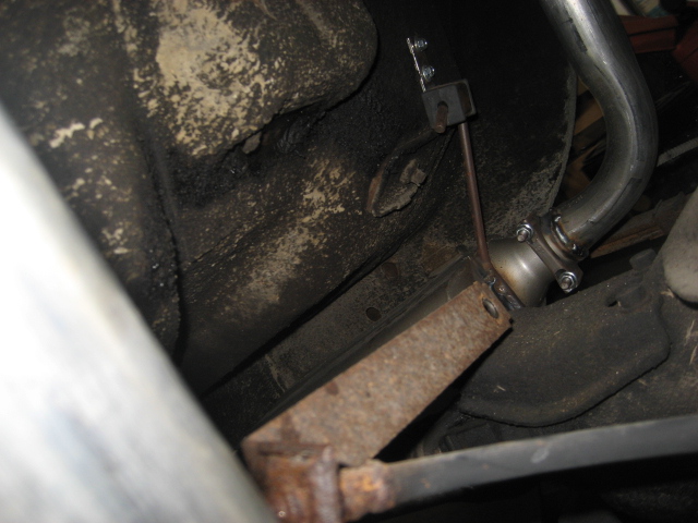

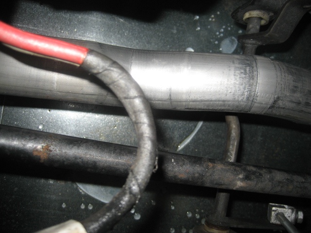

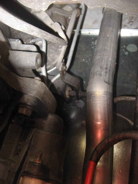

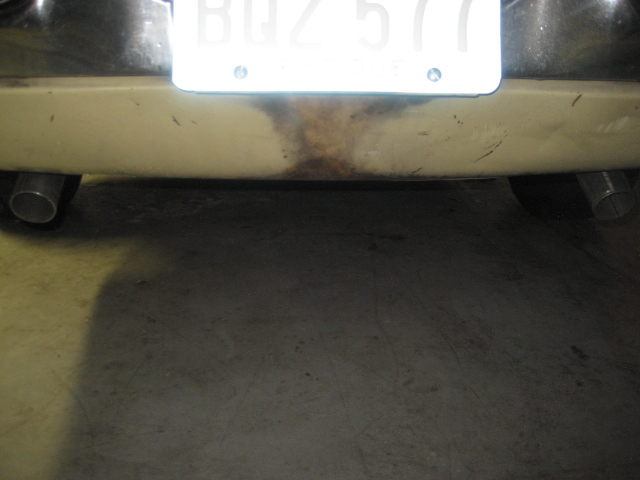

Thanks. Tomorrow I'm dropping it off to get the exhaust done. Pick it up later in the week. I love the smell of Mopars but this one will kill you. Holes everywhere leaks and missing tailpipe.

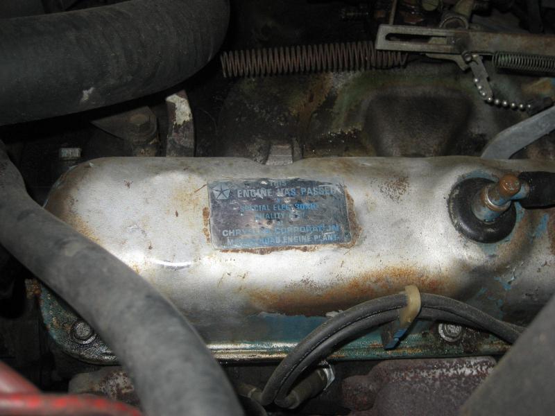

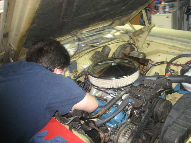

Exhaust is done and showed my son how to change the sparkplugs Will get headers at later date.

That's a nice clean looking job they did on your exaust, I bet she sounds good!

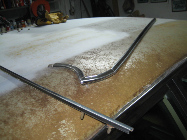

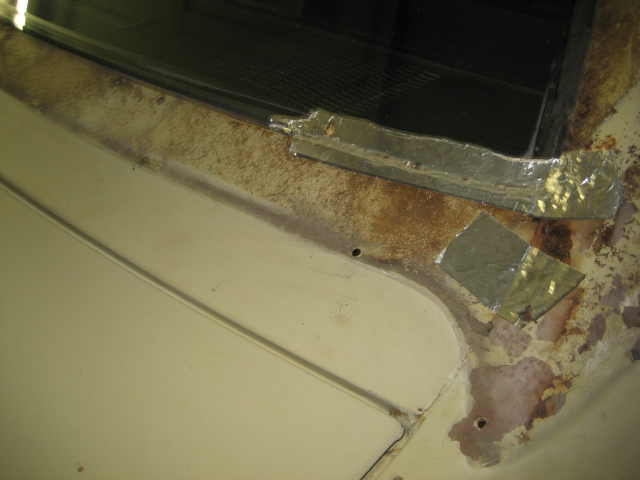

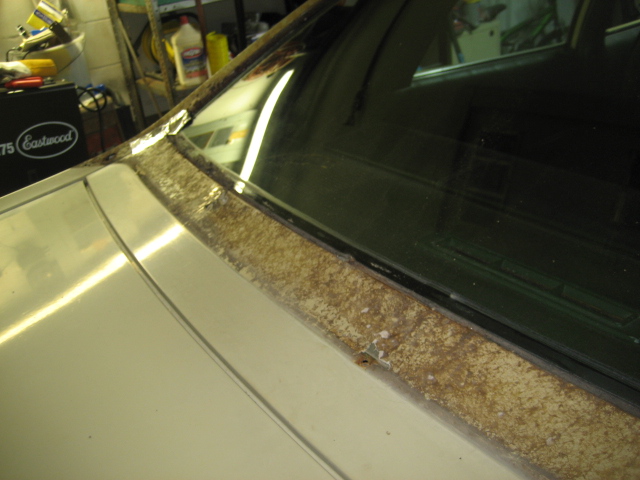

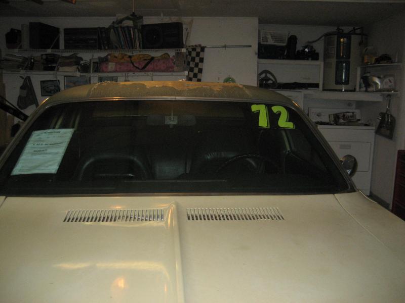

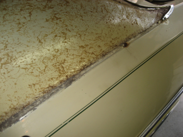

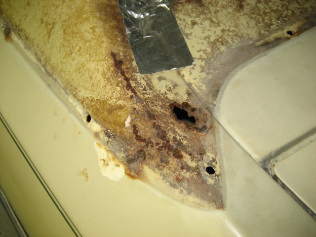

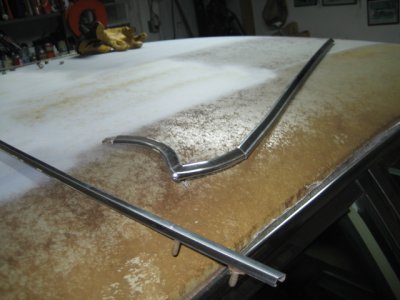

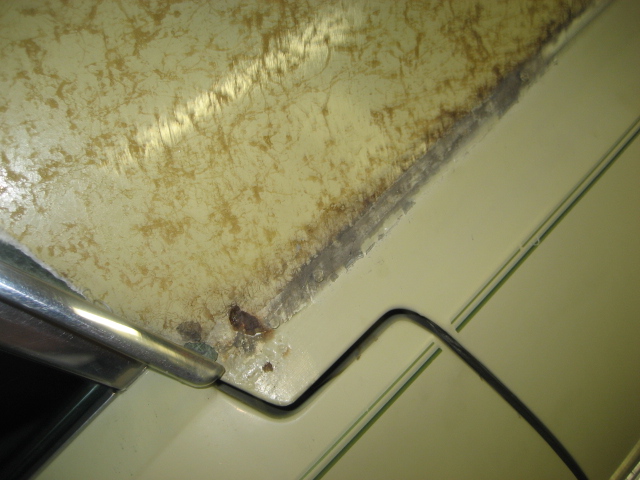

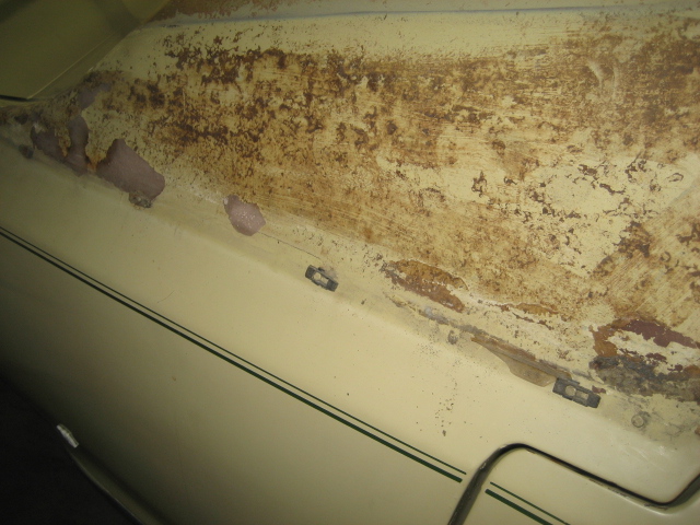

Did a little work on the 72 Coronet today. Removed some more of the vinyl roof trim. There was about 2 pounds of silicone holding the trim on after taking all the nuts off.

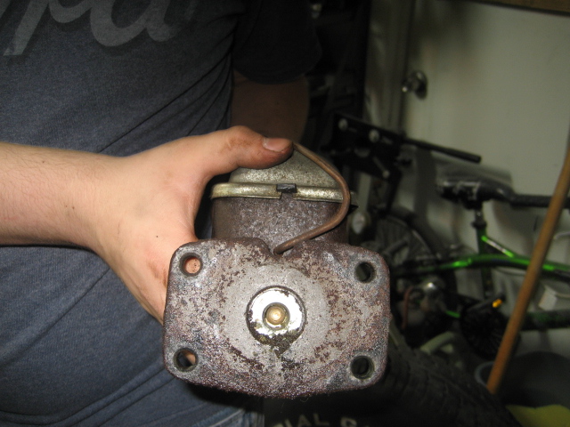

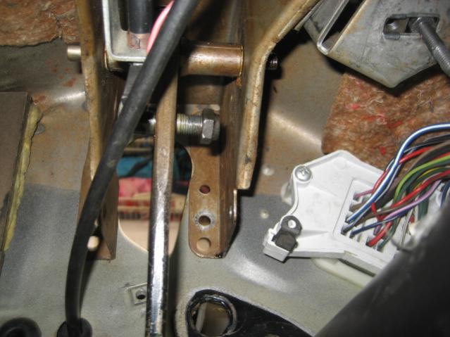

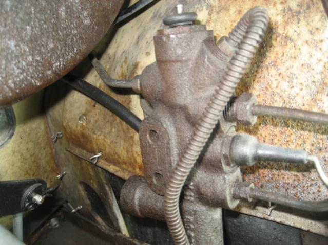

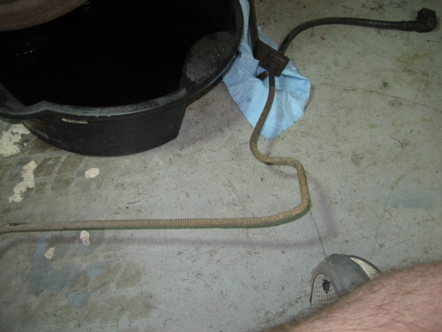

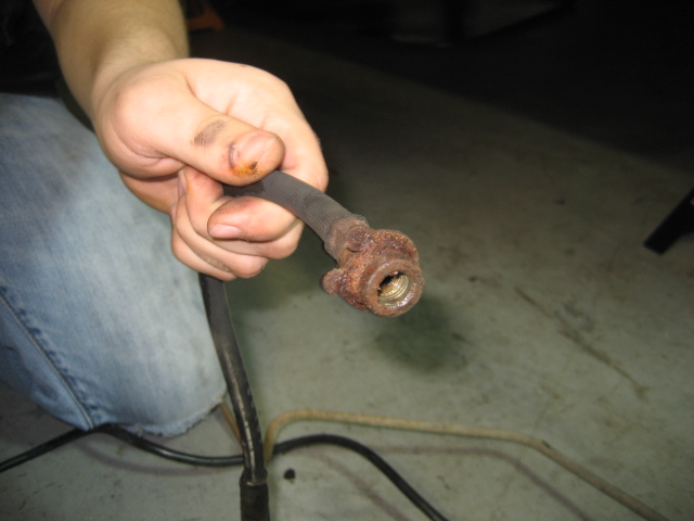

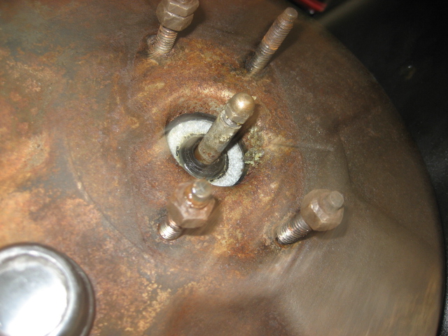

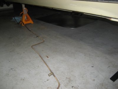

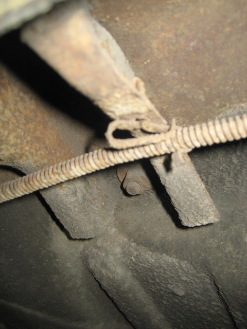

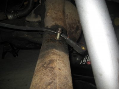

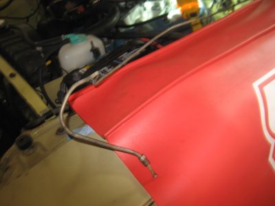

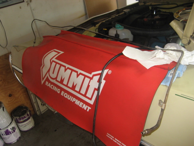

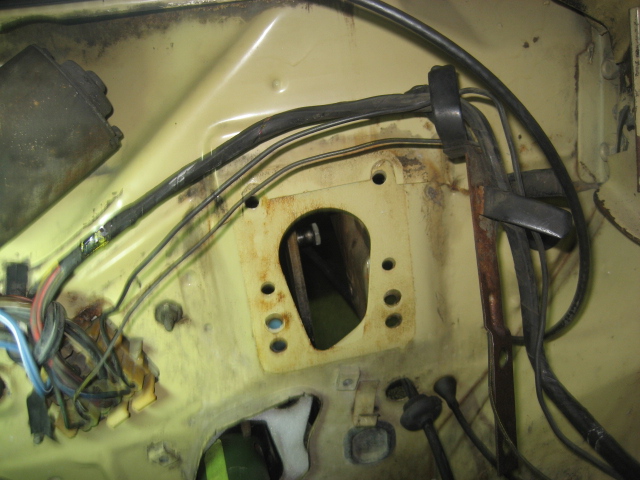

Started working on the brake system past couple of days. The brake fluid comming out of the lines looks like brown mud.

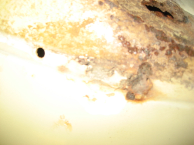

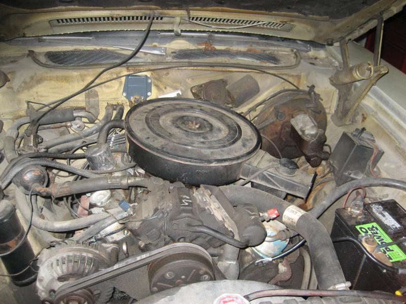

It's amazing what you find when disassembling a 40 year old car. I started replacing a fender and wound up taking the car down to a bare shell.

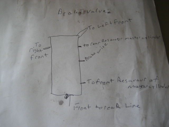

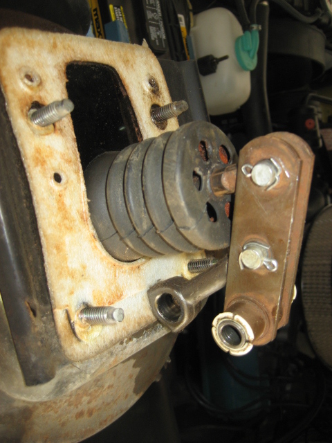

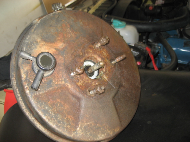

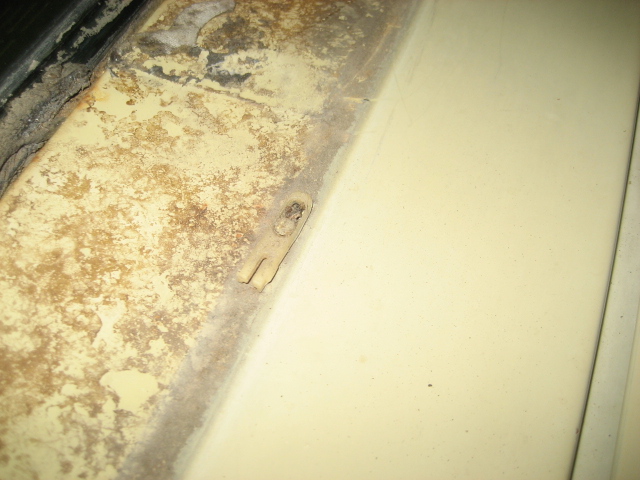

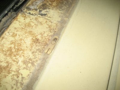

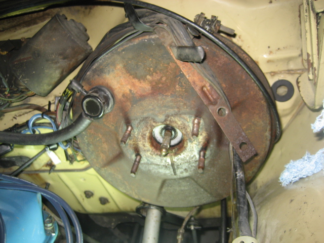

My son did most of the work removing stuff. I have most of the new brake parts. Still have to get the long line from front to back and the clips that hold it to the floor. I'm sending the master cyl and brake booster, disc brake calipers and distribution valve to The Ram Man to get rebuilt. The distribution valve is the cast iron one and no one carries them anymore. I don't want some cobbled up distribution valve that will look like crap.

You going to keep the booster?? People more knowledgeable than me suggest it's good to ditch it....

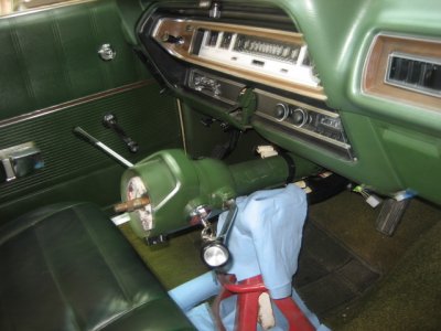

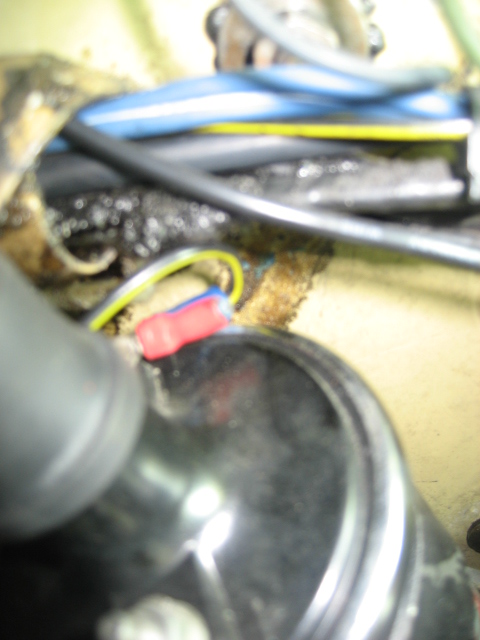

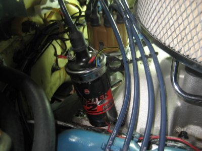

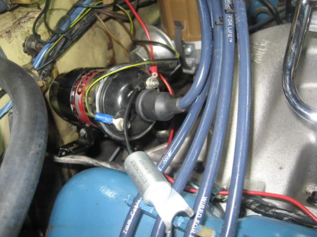

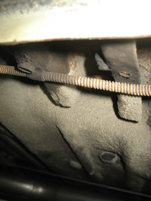

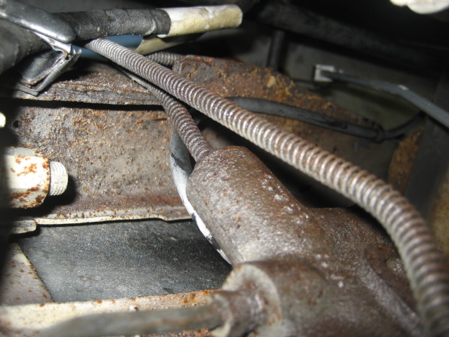

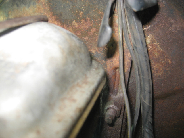

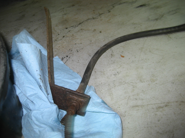

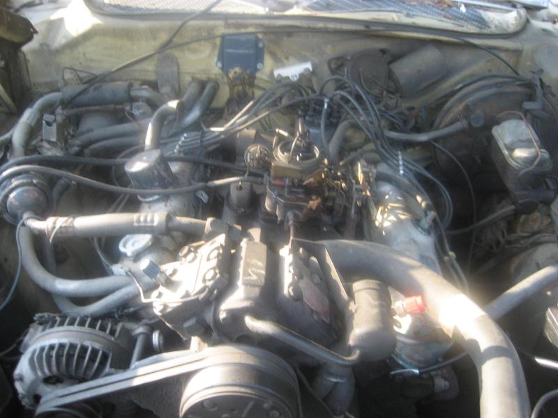

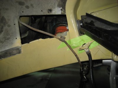

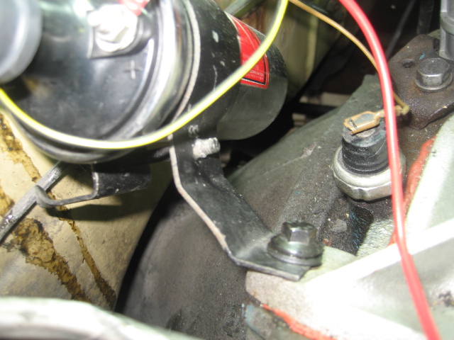

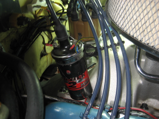

I'm going to have it restored. Finally got the right brake line out. Had to loosen a intake bolt to move the coil because when coil was remounted they put the screw head facing the firewall. When removing the fight front brakeline coil may have to be removed. I removed the line by pulling it carefully from drivers side due to the bends in line. It's alot easier to remove that way.
