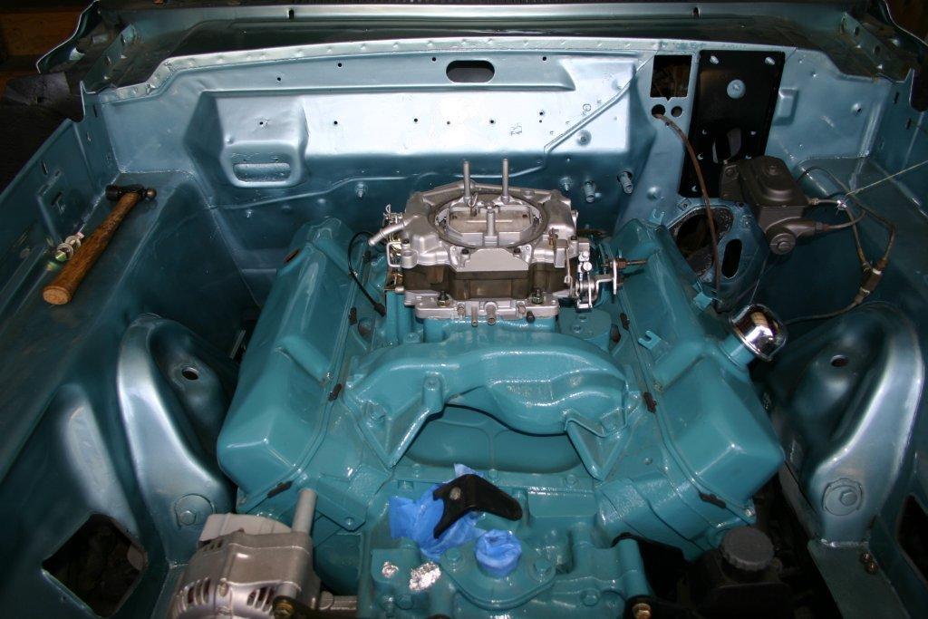

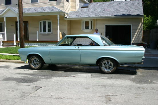

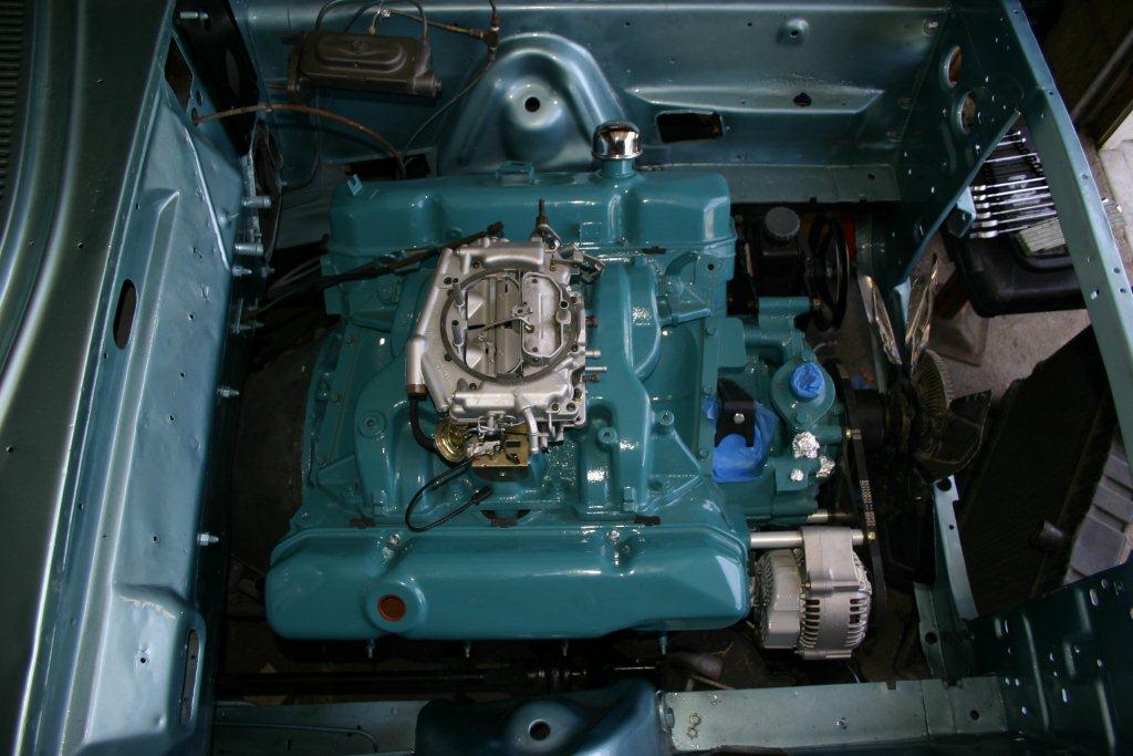

Here's what I'm working on. I've owned the car since '85 and since then it's gone through several stages from weekend toy to daily driver. It's been sitting in limbo since '96 when I bought my house. Got married and I guess life took over for a little while. Two years ago I blew the dust off of it and went back to work. Should be running once again real soon.
A bit about it:
'65 Satellite
440 - forged crank - ly rods - 9.6:1 CR
Speed pro six pack pistons
Home ported 906's
Comp XS268 solid cam and lifters
440Source roller rocker setup
Edelbrock Performer manifold
850 Thermoquad built by DemonSizzler
Cheap BlackJack headers - 1-3/4" pri - 3" collectors
727 w/stock replacement converter (for now)
Dana 60 w/3.54:1 gears
10" manual drum brakes all around (gotta go)
Just building it as a strong running cruiser as we have no track here on Long Island to really enjoy these things for what they are. If I had to take a guess I would say it'll be a low 13 second car.

Very nice!!
Beautiful car - and engine!

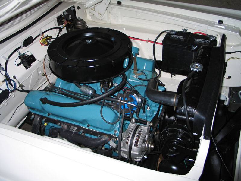

NIce looking project. I am obviously a fan of how you've disguised your 440 as the stock 383-
Thanks. I'm just trying to make it as stock looking as possible without being a slave to originality. Yours looks great and is obviously a lot more 'correct' than mine will ever be. I suppose mine might fool anyone who's not very familiar with these old cars although I'm not really trying to pull the wool over anyones eyes, just like the way it looks.
Tell me about yours, is it a '64?
Yep it's a 64 dodge 330. I am doing what you are doing- mostly a stock look that keeps the nostalgia of the original cars. But I didn't go nuts with every little part totally correct. I just kept away from the chrome bits and stainless hardware unless I was going to paint over it.
What's the next project on the 65? Looks like it's going to turn out really nice.
After I get it running I want to put the interior back together. New carpet, headliner and upholstery from Legendary. The next mechanical project is brakes/suspention. 10" drums just ain't cutting it.
Satellite65..That sure is a pretty color you have on that car..Looks sweet! Good luck on the rest of your resto. Can't wait to see her all together!
Hitit.......That's got to be one of the cleanest looking under the hood shots i've seen...Great Job! Beautiful!
Thanks. YOU can't wait to see her all together? How do ya think I feel? LOL
I agree. I hope mine looks that good when it's done
Nice looking project. What color is that?
It's the original color, medium turquoise irridescent but I think the paint shop may have gotten the mix a tad lighter than it was supposed to be. I had some mixed recently to shoot the engine bay and it's about a half shade darker than the exterior. I ain't complaining, when the sun hits this thing it's blinding.
