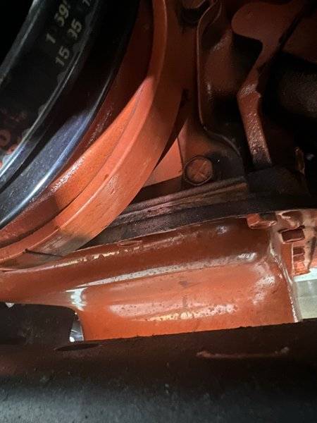

Its about 1" thick across the timing mark area. Pic. attached.
I can't tell much else until I pull the water pump, which I need to replace anyway. It you think its worthwhile, I'll pull the pulley on the bottom too, but I think a scope through the oil pan screw will tell me that story.
Still seems like stock to me, but you guys know better.
Actually, maybe it's a thin one?
It looks like you have a damper for a forged crank likely w the standard Ly rods. That is what would be expected for a 70 engine that is a non hp( no hp stamp up top on the front bad.)
Engine looks really clean for a 2015 rebuild!
That would be nice for forged. The builder did mention new rods, so we will see what he put in there. I am hoping to catch some markings on them when I scope the bottom end.
No HP stamp. (Although I thought that didn't affect the block anyway and was just the internals???)
Correct...hp is just a stamp, blocks are not different. A 70 440 hp should have the heavier rods like a six pack and be externally balanced. Hard to say what rods were used, hopefully you have a good aftermarket set with good bolts.

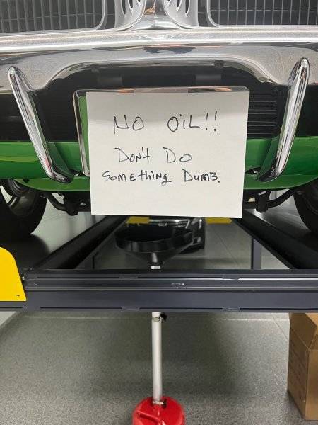

OK, now I can't wait to find out. Draining the oil now and going to wait until tomorrow so that the internals are pretty oil free. I'll scope it then.
Thought you might like my sign since I am going a day or two without oil in the block.

Nice sign... smart man.
