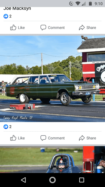

Nice job on the new best!
Magnolia put up a nice picture of you on their latest Facebook post.

This is the photo from Mag.
That’s really cool.

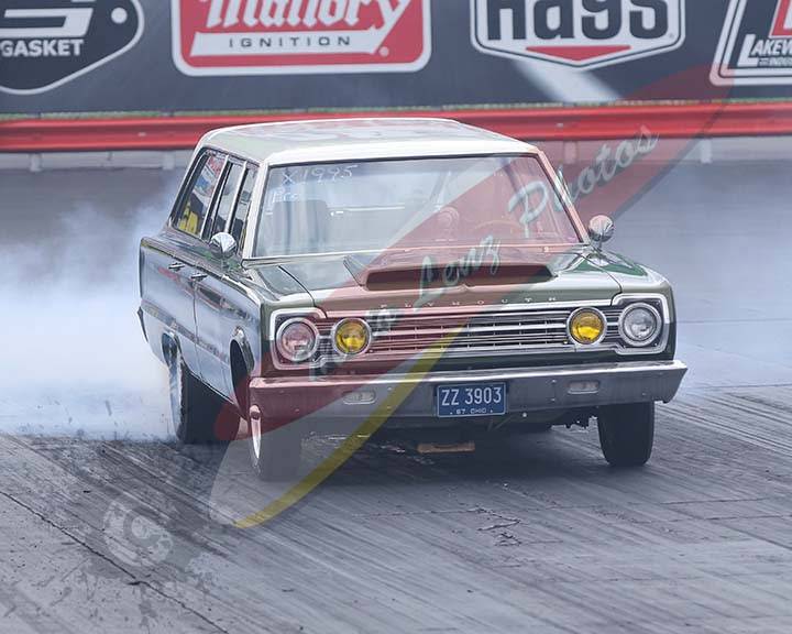

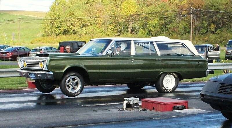

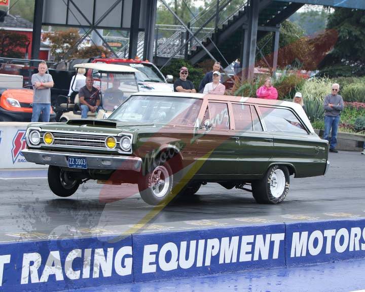

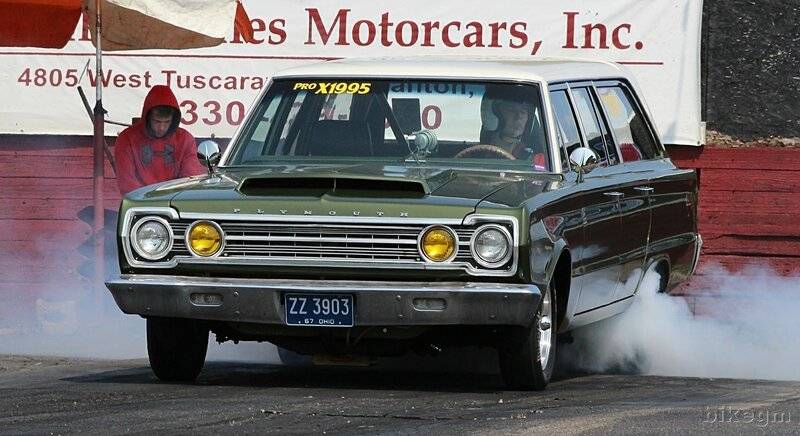

Where can I see more pics of this wagon, and run-down on your combination?
I'll post some more photos.
The combo is nothing special but it works well and is fun to drive and race.
400 block with a 44Source 4.25 crank and rods. Pistons are Diamond. I run unported Edelbrock Performer heads. Nick Wilson corrected the valve job. Compression is 11.5.
Cam is by Comp duration at .050 is 242 and 246(I believe its been together for 6 yrs). List is around .557. Untouched M1 intake and a quick fuel 1050 Dominator done up by Lightning Carbs in Orlando Fl
Auto trans, 9.5" converter from PTC, dana with 410 gears. Launch is at 2500 and shift at 5500. Car weighs 4120 with me in it.
