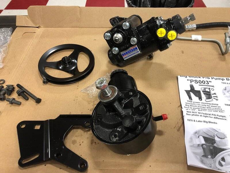

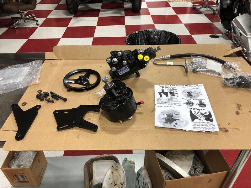

Guys, just got my first b body big block on the road a few weeks ago and it drives/handles awful . I went with a stock rebuilt gear box and original to the car, Federal ps unit. Even with the best alignment possible , driveability was crap. This is a 73 with big tires but my 72 small block with big tires has very acceptable handling and its all stock. So, in seeing the many opinions here, threads by K Dog, I ordered the Borgeson unit with Saginaw pump from Peter Bergman. The search is on finding a cure for this wondering beast.......

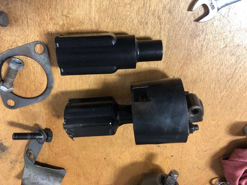

The steering coupler I meant is not the "rubber donut" thing. Did you read the link to the other thread I posted above? Those metal swivel/slide couplers do wear out, and cause excessive play in the steering. This is what I am referring to:
Yes, BBD, I installed a new coupler kit, fresh lube. When I had the motor out , k member out for rebuild, I stripped, cleaned, painted the engine bay and underbody. I replaced EVERTHING I knew of to bring the car up to OEM specks. When I was younger many times I did not have the time or funds to do things as needed at its appointed time of disassembly . No more, I have both. When you have worn parts in service and sub par performance , one can understand that. So, now, I am replacing new parts with up graded parts. Got new Tier 1 upper control arms on the way from Peter Bergmans. I may need to go with his roller bearing idler arm next if I don't reach a level of service I seek. Thanks to all the posters here, learning whats new for our cars and how to make em better , is much easier.....a great bunch for sure......

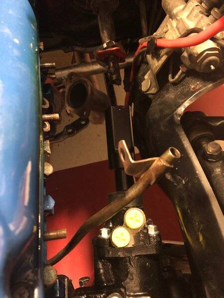

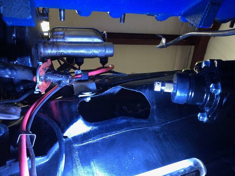

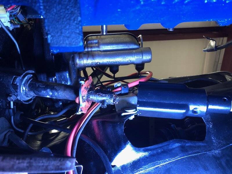

As you can see, the Borgeson unit with the no cut, direct fit coupler is short by 3 to 4 inches to reach colume shaft on the 73. Appears I'm gonna have to adapt their Helm joint coupler as well, unless Peter has a better solution . Its good to have patience when these challenges arise......
