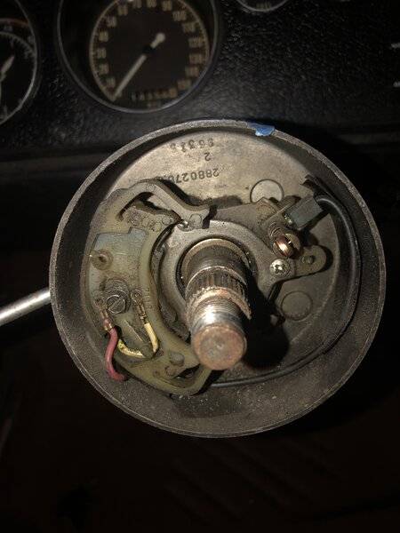

Your turn signal switch is the culprit. Probably not returning all the way to center when cancelled. Did you by chance repaint your steering column? If so I had the same problem and had to clean the paint out of the turn signal mounting screw hole to allow it to cancel properly. Try wriggling the turn signal lever to center and see if you have brake lights.

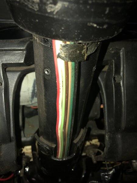

That comment threw me off as well, but I believe he's suggesting you cut the wires to pull out the harness and then put the new one in. Now you have the coloured wires still in the plastic connector to make it easy to swap colour for colour vs making a little drawing or taking a picture.

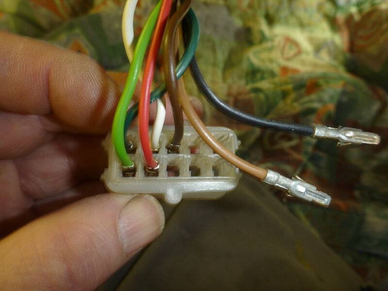

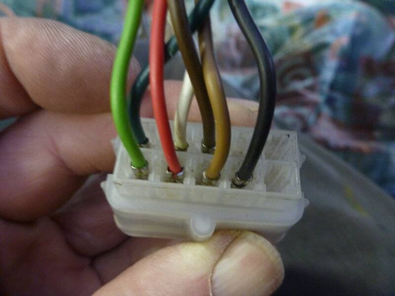

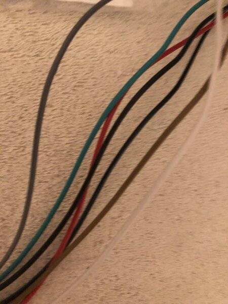

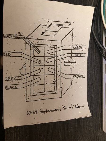

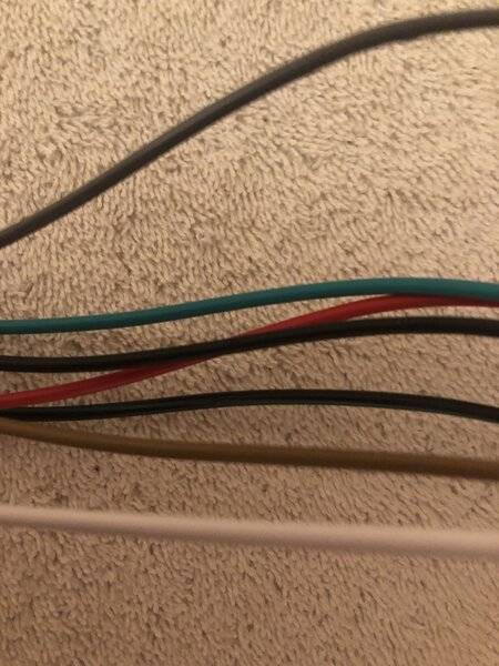

The colors of the aftermarket one doesn’t seem to match the original one black wire has a green stripe on it on the aftermarket one
4B1CCD8A-6CE4-4C87-91A8-E91D79C43200.jpeg C776C422-FDF7-44B2-9C51-D2ED85A74838.jpeg
Aftermarket colors are red white brown gray green black and black with green stripe
Do the old connectors just pull out
With an extraction tool or a small jewelers screwdriver.. you need to slide it in and push the lock tab back.

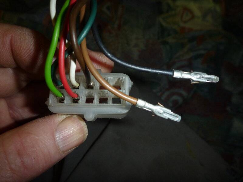

..as for the aftermarket wire colours, you'll have to compare the OE to the replacement as to where each wire goes in the switch so you know the correct placement in the connector..
I can't say one way or another, why I said to compare OE to replacement and where the wires go in the switch. I've never used a reproduction switch as they're known to cause heartache...
