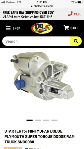

Looking at this one. About $80
I started using the mini's 25 years ago and never looked back. No comparison to the old mopar starter. No more hot soaks or drag. You will think you have a new fuel injected car.
