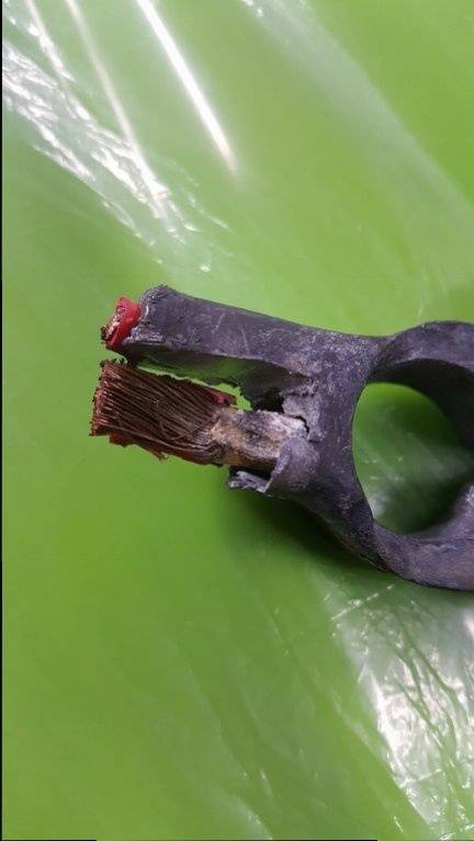

I had the same exact problem after rebuilding my engine. Had a new starter but just clicked, went and bought another and did the same thing. Battery was good. Voltages were good all the way down to the alternator. Put a jumper wire straight from positive terminal to lug on starter and it turned over ! Turned out the brand new battery cable was corroded where it was molded in the terminal. Replaced terminal and been good ever since. Voltage was good, current flow was **** !
I had the exact same thing happen to me. Try to start and just get click. Got the meter out and 12V from switch to relay. 12V from relay to starter. 12v+ on battery. Replaced battery. No change. Replaced relay. No change. Replaced starter. No change. (Auto parts store said both tested bad.) Ran jumper cable from battery to starter. Started right up. Pos cable end looked perfect but new cable end solved problem. Cable was only a year old.
Glad to see I wasn't alone on this one ! My cable was made by goodmark, and roughly a year old. Here's a picture of the terminal after I cut it open to investigate ...
