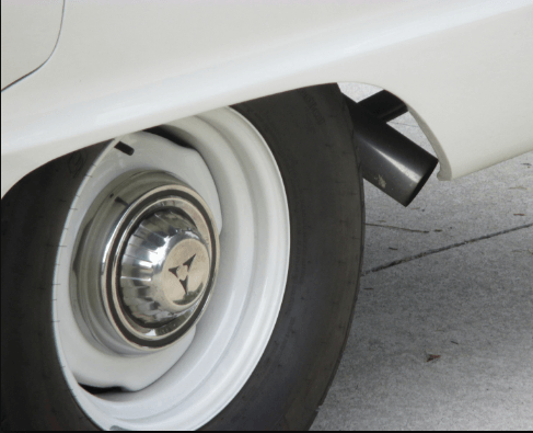

I'd like to stuff larger tires onto my factory wheels in the back. does anyone know where i might find modified versions of the factory style wheel for rears, ie does it makes sense to get them fabricated, or is there a source that sells them. I can go with 4.5 inch backspacing. I've attached a few pixs that show my current factory wheels that i have. i'm also looking for those center caps as well. i'm guessing the best source for those are ebay, but open to suggestions. Thanks in advance.

Common practice to separate the center from the rim or ring and and weld on a new wider ring. Not sure if Stockton Wheel is still in business but they were the ones that you could go to years back. A buddy used them for his Super Bee but it took 3 times to get them right and one time the wheels showed up with Ford centers. Might try Wheel Vintiques but last time I looked at their site, they were advertising Ford and GM and saw nothing about Mopar....but here's another place.

summit has wheel vintiques 15x8-4.5" backspace. that's about all the wheel, with a 275-60x15, that your cars wheel well will take.

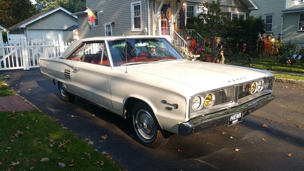

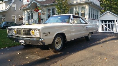

ok, here's my plan. I'm going for the "COPO" plane jane look. I was thinking of going with the wheel vintiques shown on the linke below for both front and back. Car currently has 14 inch wheels on it, see attached. i'm not really fond of the hubcaps.

I need to know if i should go with the 15X7 or 15X8 rim.
For the front, because i don't have power steering!!!!! i was thinking of getting skinny's. Either way, i would like to somehow ensure that the front tires side wall's should be around the same height as the back tires shown above. Open to any suggestions.
