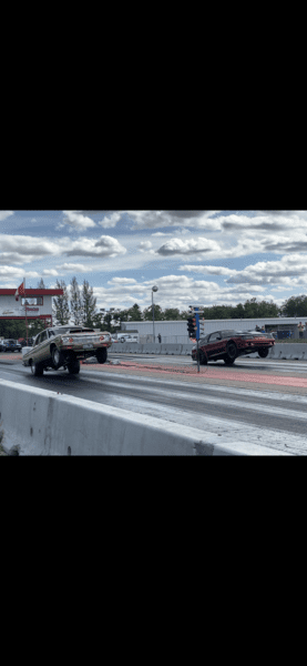

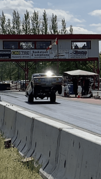

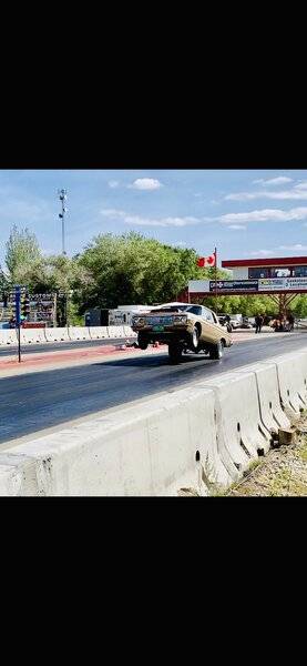

Back at it. Day 2. Went out second round like rookies do.
Ran 10.12 consistent all day. Some quick pics. Oil
Pan kissed the track again too.
Your hits and take off are on the mark from the pics. You got to be happy with that for sure. Is a skid plate in order to protect the pan or ?. Might have to put wheelie bars on it ?.

Great air under the front. Sounds like she's coming around. Hope the pan held up.
For today I tightened up the front shock rebound and that took some height out of it. Went 4 rounds. My 60’s were consistent 1.34’s, with the exception of 1 1.38 60. The cause of that was the only half the burnout box with water, got me sideways, right away, then spun on the launch. Come 4th round I nail a 1.32 60’, broke out by .007. Still was a great day of racing.
Thanks, yeah the car works great. Added more rebound to the front shocks today and that took some height out of the wheelies. Running 10.06’s today, right where I want to be while keeping on the safe side of 10.0
Is 10.0 the limit or 9.90? Also would a stiffer torsion bar be of any help? Might help take some of the strain off the shocks.
I wonder have you checked to see if it's bottoming out on the rebound bumpers? Just curious.
10.0 is the limit for me and I’m right there now. I like nothing better than to hang a nice wheelie and run 10.0’s, that’s where I’m at. Dropping down right at the cone. Adding more front shock rebound was the answer for day 2. Those front shock rebound knobs are like a wheelie height adjustment, how much better could it be. :)
Rebound bumpers bottoming out? Well I had just installed new lower control arm bump stops and both of them were knocked off. Just the inner studs were left. I had a used pair with me from upper control arms, installed those for the day, no further issues, was smooth sailing on Day 2.
For the next outing I’ve bolted on the new tires and will see how the car likes those. There’s 3” more rollout, will be adjusting the front shocks to get the right launch. The other thing that really effects my launch height is the DA. Good air, up and away.

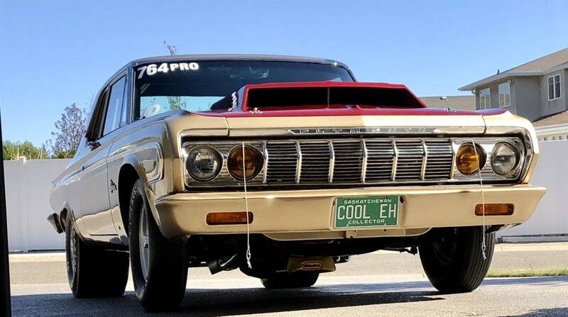

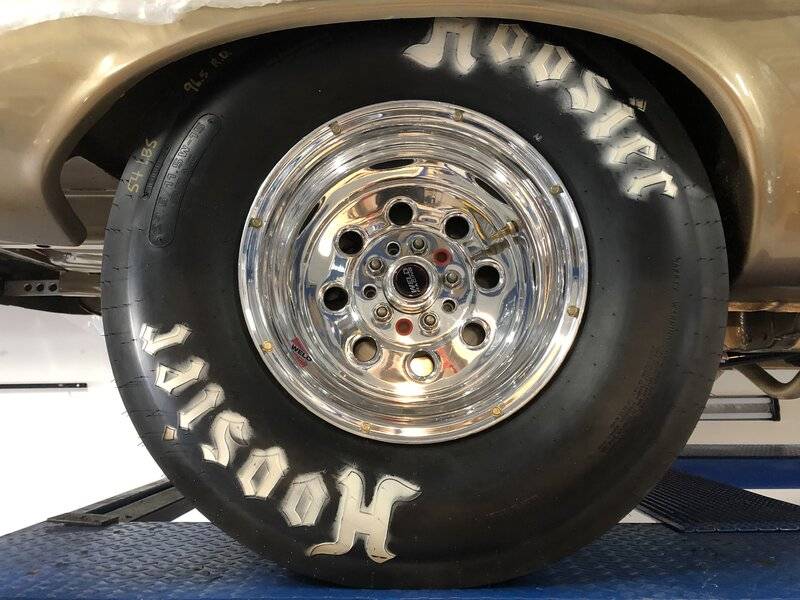

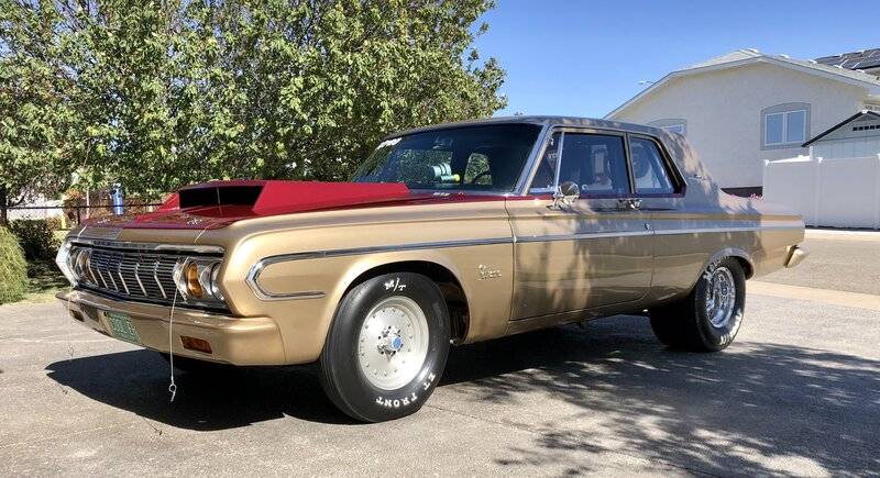

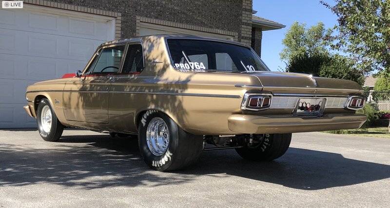

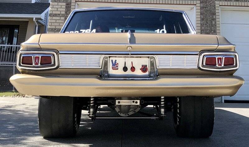

Time to hit the home track for the 2nd and final time this year. Weather is supposed to be good this weekend and perhaps Wooks and I can both dip into the 9’s a time or 2.
Changes: Trying a shear plate under the dominator, some jet changes, hockey pucks for bump stops and new big rear tires.
Hoosier 29.5 X 11.5 W’s. 96” rollout, 15.2 cross section and 13.25” tread. The new big tire’s additional circumference may take away a little on both ends, maybe not, we’ll soon know. Maybe turning the little 505’s launch RPM up some too!
