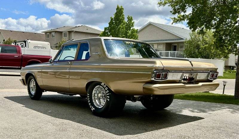

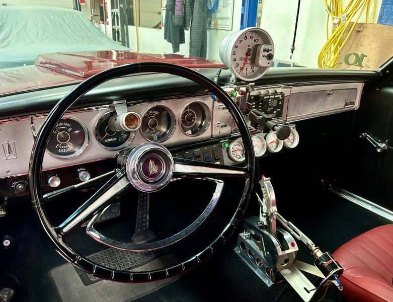

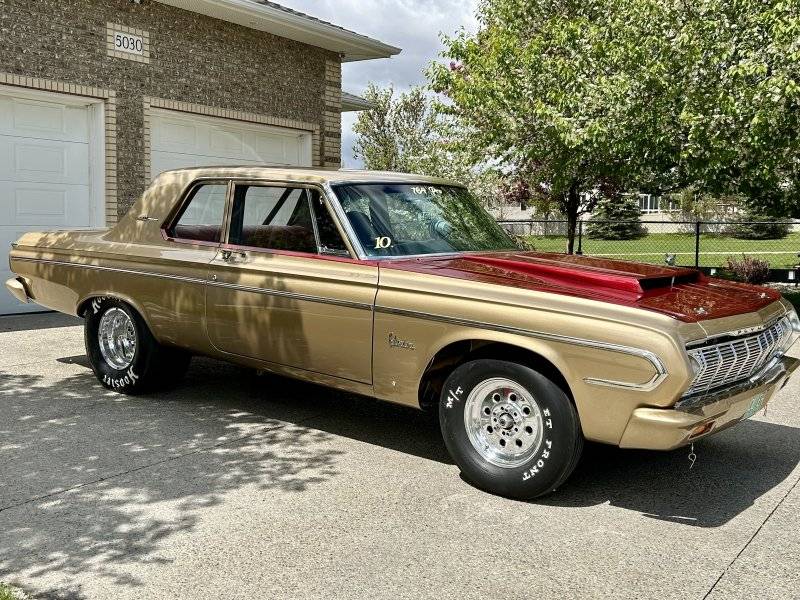

looking good Malex . Not sure I love those paper(?) filters for racing . I use a screen , actually a kitchen sieve to clear under my scoop .Well gang. Look what I dug out of the archives. This old thread. It’s been buried a few years too. This old thread was a FBBO joint effort in getting both me and this old Plymouth down the track, thanks again to all that had a hand in it.
So it’s time to hit the track again, the first time out of the garage this year and tomorrow I’m headed about 300 miles west. My local track isn’t up and running yet due to some delays in pre-season upgrades and the year is slipping away so here we are.
Was expecting Wookie to maybe show up this weekend but he’s out now, and Remcharger, well Rem, you coming racing?
Anyways.

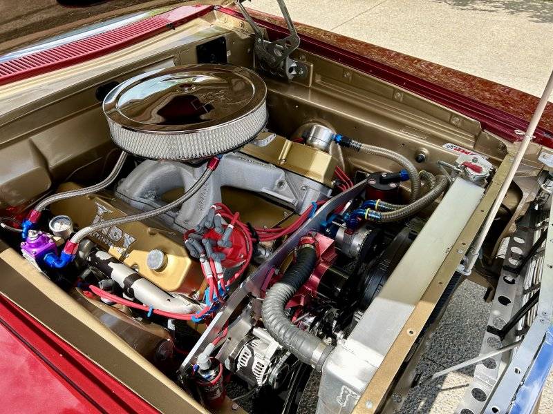

The off-season changes were a different RB block due to a crack in #2 main web (it pays to freshen). I was able to lose 102 lbs in the off-season but added 20 lbs back on with a partial hard blok fill and billet steel main caps in lieu of the aluminum caps.
So lots of changes and probably some bugs to work through. We’ll see how it goes..
Starting over fresh and clean. A 16X3” air filter this year. Shorter due to a new scoop. The rest of the package remains the same.
Liking the looks of the new 3” scoop.
On with a set of lightweight Strange rear disc brakes and off with 28lbs just like that.
hoping for the best!
Yeah the jury is out on this filter. I can’t recall if I looked for a K&N in 16X3. Yet. And wow did you ever rock last weekend. I’m not looking for much this weekend other than getting things sorted out. The new electric shift I hope I don’t forget and pull. Thanks and good luck in your finals coming up!looking good Malex . Not sure I love those paper(?) filters for racing . I use a screen , actually a kitchen sieve to clear under my scoop .
