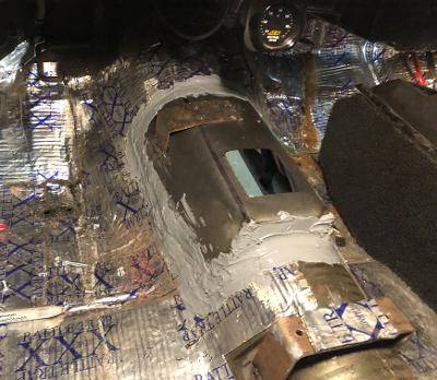

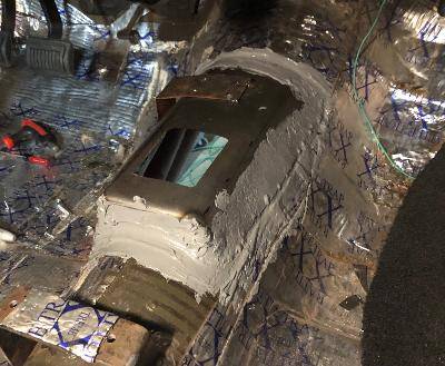

The tunnel patch was covered in seam sealer too.

The stuff spreads like thinned out Crisco. I used a putty knife at the seam and then spread it with my hands. It looks thick but really isn't.

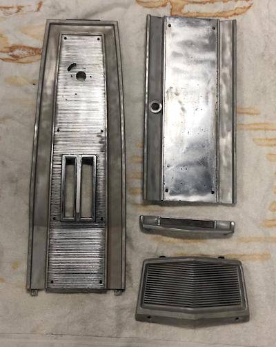

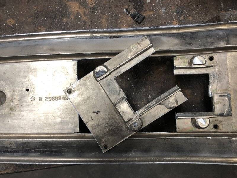

The Tremec transmissions from Silver Sport are modified to fit these cars and are supposed to end up with the shifter in the stock location that the 4 speed cars used. I knew that I was going to need a different console plate for the manual transmission since this car has always been an automatic. My other '70 Charger Jigsaw was built as a column shifted automatic and since I intend to convert it to a floor shift, I was going to need some parts to get there. It came with a bare console so I was going to need the courtesy lights, side trim and top plates. I decided to pull the top plates from this red car and set them aside for Jigsaw.

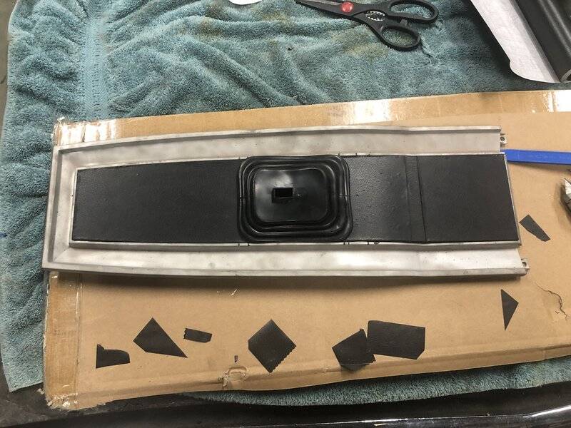

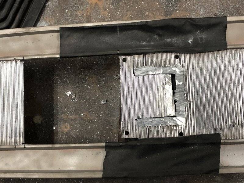

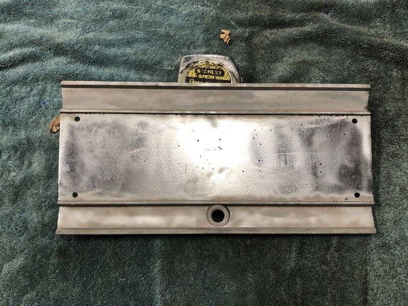

The 4 speed console plates are harder to find and overpriced so I decided to modify one that was for A/T cars. A FBBO member sold me a set of plates and I set about to modify the one for the shifter.
It was a sort of simple deal with a little measuring and cutting, JB Weld and some finish work. Everything is going to be a matte black when I'm done for a subdued look.

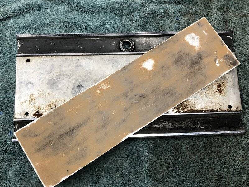

The console door that came with the other pieces was sandblasted along with the other parts but on closer inspection, I can't use it. It came with broken pegs that the hinge attaches to and it was missing the thin aluminum plate that the woodgrain decal attaches to.

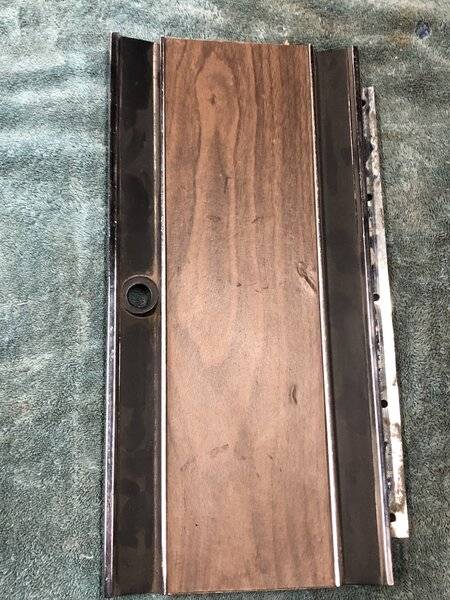

Another FBBO member came though with a huge favor and sent me a nice console door similar to this one, the original from this car.
I stripped off the clearcoat of the woodgrain decal and plan to sandblast the door to get the paint to stick
That plate will get the same type of vinyl covering that I'm using on the rest.

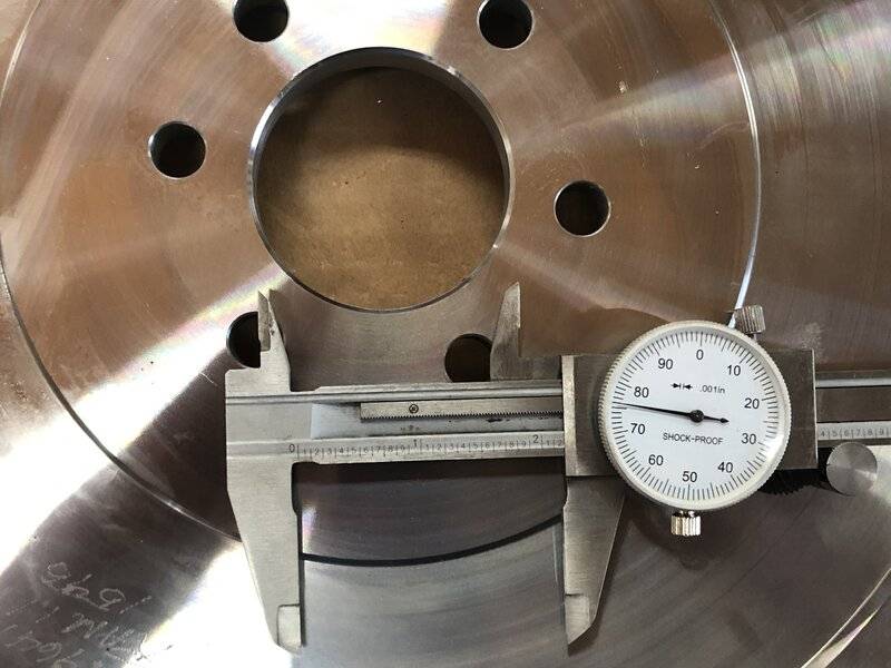

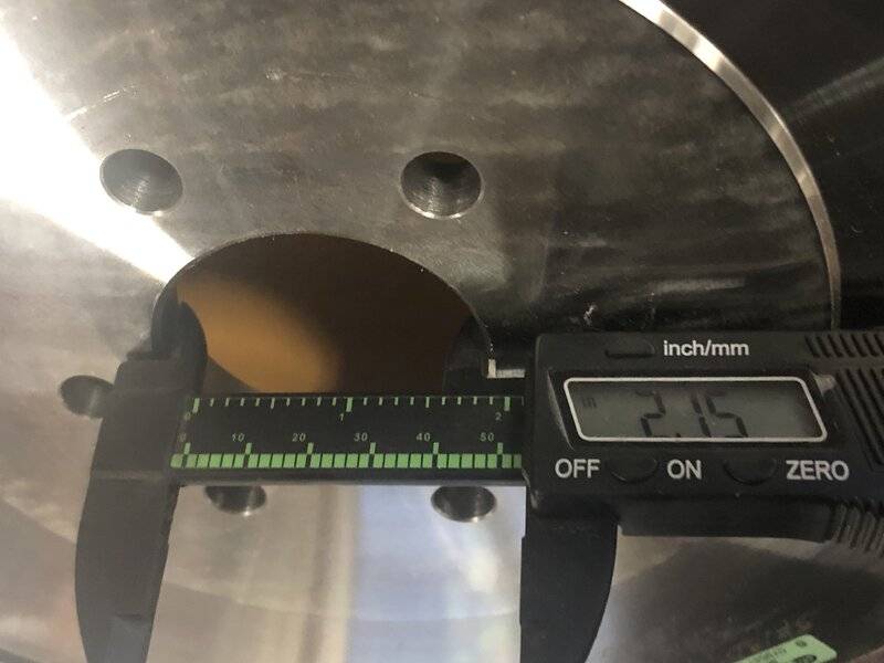

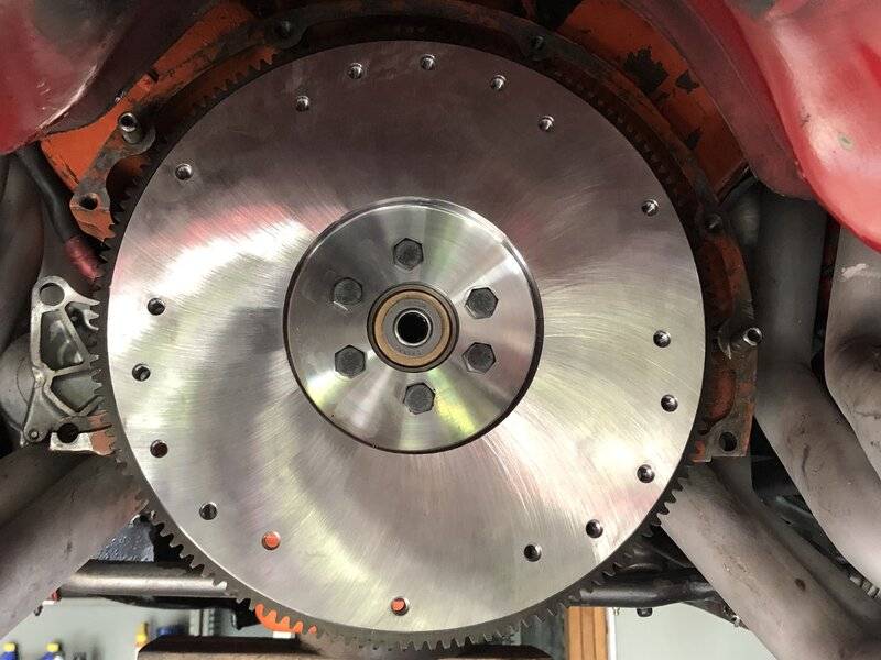

I got the call this morning that the man was done with the flywheel. $60. I gave him $80. He was pleased. I was relieved.
The caliper reads 2.176 but slipped slightly from the 2.179 number I measured.

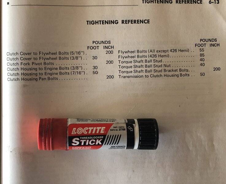

It is in place with locktite and torqued to spec. The SST instructions had no torque specs so I deferred to the service manual.
