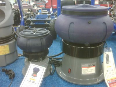

I bought one of those vibratory tumblers from Harbor Freight a few years ago to polish diecast pieces. I bought a bag of crushed walnut shells for the media...not really much to talk about....it didn't do much. I guess the media was wrong for the job.
Looks a lot like the picture below;

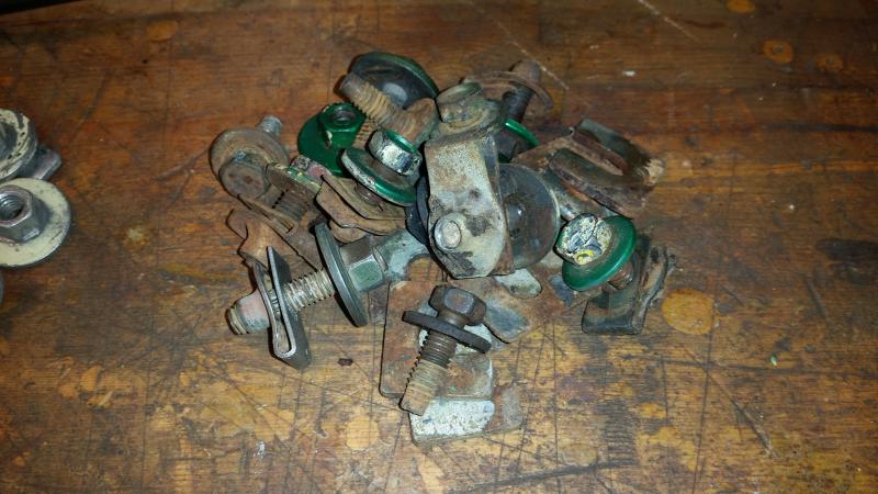

OK here we go.... tumbler update
here is a before...simply put it in the tumbler with some green pyrmaids

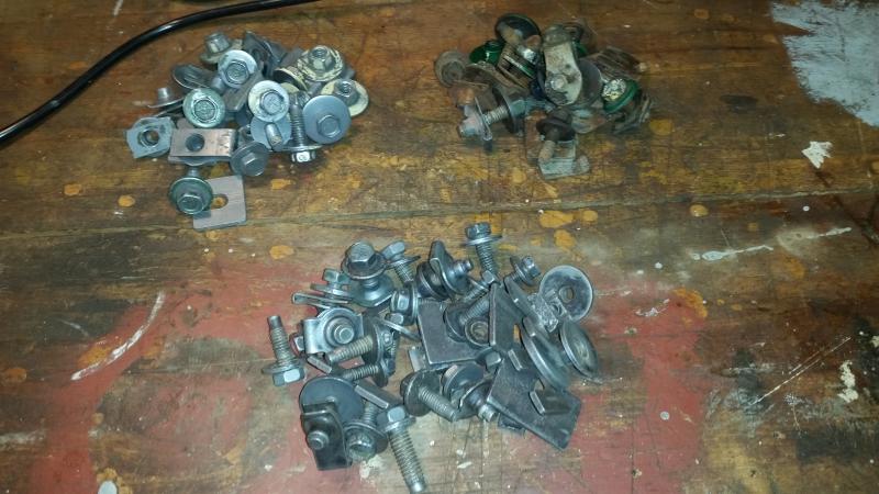

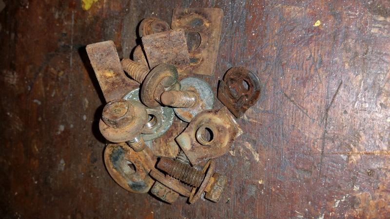

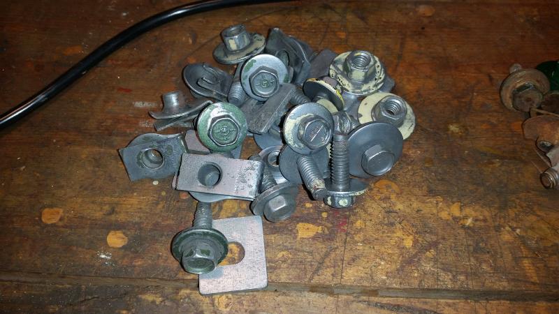

Upper left is evaporust for 24 hours or so, a wire brush job or two, and a few hours in the tumbler with some walnut shells. Basically the only thing left is some of the OEM paint. Front center is some time in the tumbler....this in my extra hardware for an experiment. It had green pyramids plus some other media (which I thin was a mistake)
same note as above, evaorust and some tumbler time
these are waiting for the tumbler......front fender hardware. They are in there now with just the pyramids.
