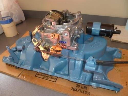

Just install you a Edelbrock performer or something the equal. A nice 600 cfm carb would fit the bill on top.
Or a old Edelbrock LD4B if you can find one.

I agree on an Edelbrock 500/600 CFM carb.
IIRC the matching Performer 318/360 can be used with your AC comp and brackets.

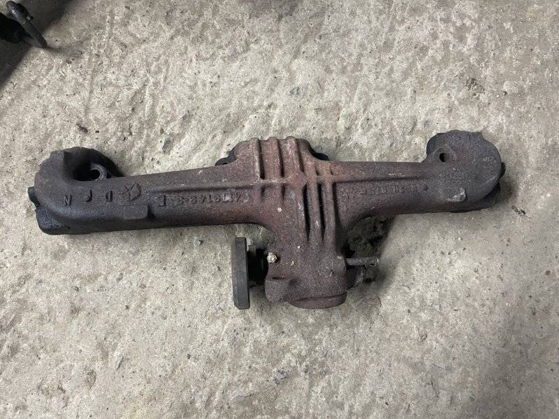

There's also the air pump and associated steel lines.
...and those pesky air injection ports under the exhaust manifolds if yo're not planning to use those manifolds.

I have the stock manifolds from the donor car. The car has an oil filter adapter which puts the filter at a different angle than what it was on the stock 65 poly 318. Going to look into headers for the 65 with a mid 80's 318.
